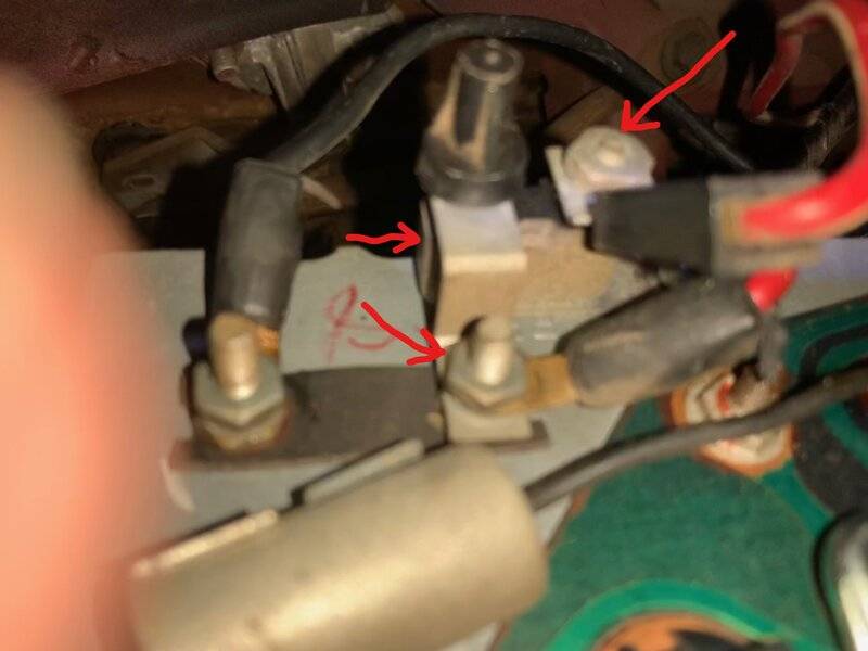

As I recall, there is a circuit breaker connected between the ammeter terminal and convertible top switch, and the circuit breaker is really close to the ammeter connection. I really don't like the fact that the switch has full power all the time, and all the power goes through the switch to operate the top.
I plan to power the pump through some relays, and will likely add some arming switch to the circuit so it is not active all the time.
On my Power Windows, I added a switch to disable them so the grand kids don't play with them when I'm driving.
Here is a not so great picture of the back of my ammeter (69 GTX Conv)
the top right arrow points to the connection that goes to the switch for the power top
The top left arrow points to what I believe is a circuit breaker
The bottom left arrow points to where the ammeter connects to the circuit breaker (L shaped metal connection)
