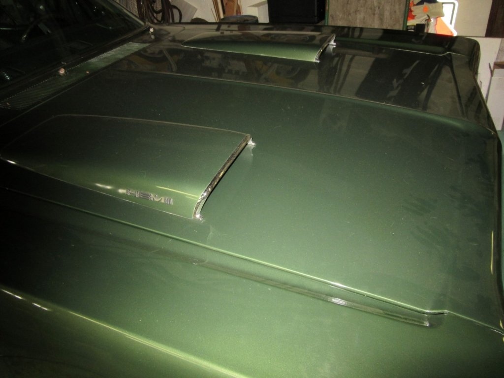

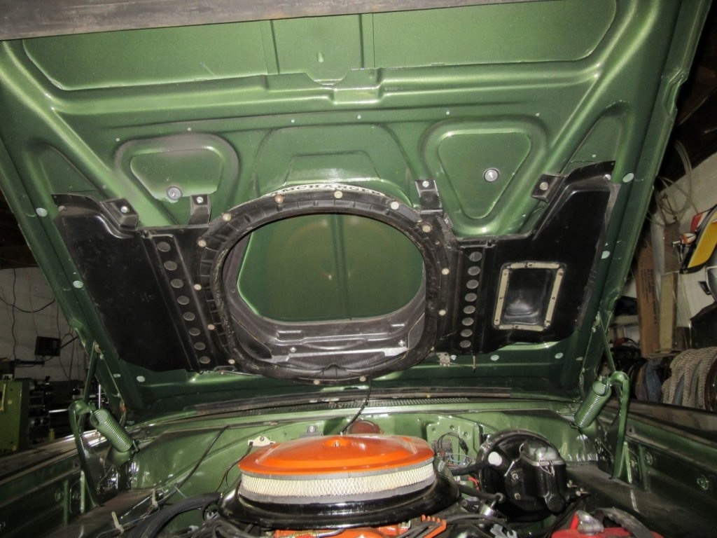

I just happen to have one in good contition and it is on my list of things to sell.

Your set up is exactly what I'm looking for. I have seen aftermarket scoops, but someone told me they warp after time. I would consider the bulge hood only if there is a practical reason for it, like clearance issues. But I am wanting mine to look as close to a "real" RT as possible.

In my case you will see a formed rubber indentation/cutout in the underhood assembly that was made to clear the master brake cylinder (when the hood is down) on -hemi only- cars.---The booster assy. needed to be moved up and to the drivers side cause the hemi is a fat engine.:)
