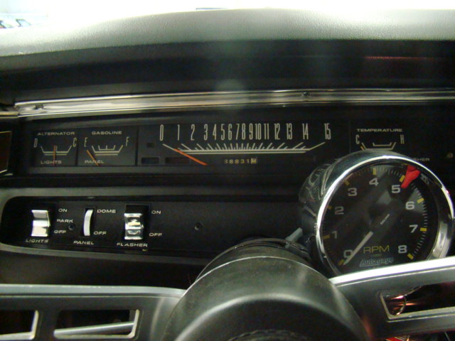

Hey gang, It's advice time again. I want to remove that ugly column mounted tach and install the correct in dash tach in my 69 R/T. I found a perfect copy with the harness from Gotham City Motors, so that's my next project.
What's the easiest way to install this? I'm sure some of you GTX/RoadRunner guys have done this too. Why the Rallye Dash wasn't standard issue on a premium car is beyond me! Thanks in advance.

Hey guys, thanks for the input. Perhaps I was off on the "perfect" part, but I think it's the only game in town. Supposedly these tachs have updated modern guts, and it's more for looks and basic info than anything else. I haven't seen one in person, I'm going off the picture provided by the vendor. And no, the car has no AC, so I might be able to wing it in place. I thought I may have to remove the cluster to access it. MarPar is dead on about you, Dodge. That's a very informative and detailed explanation. Thank you!
