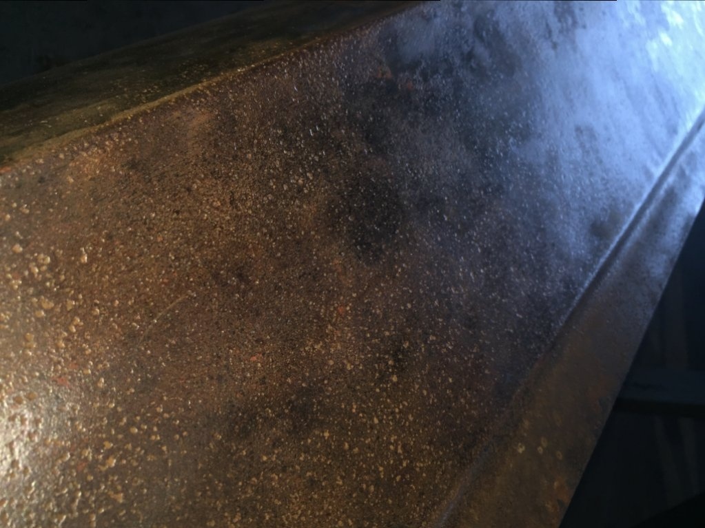

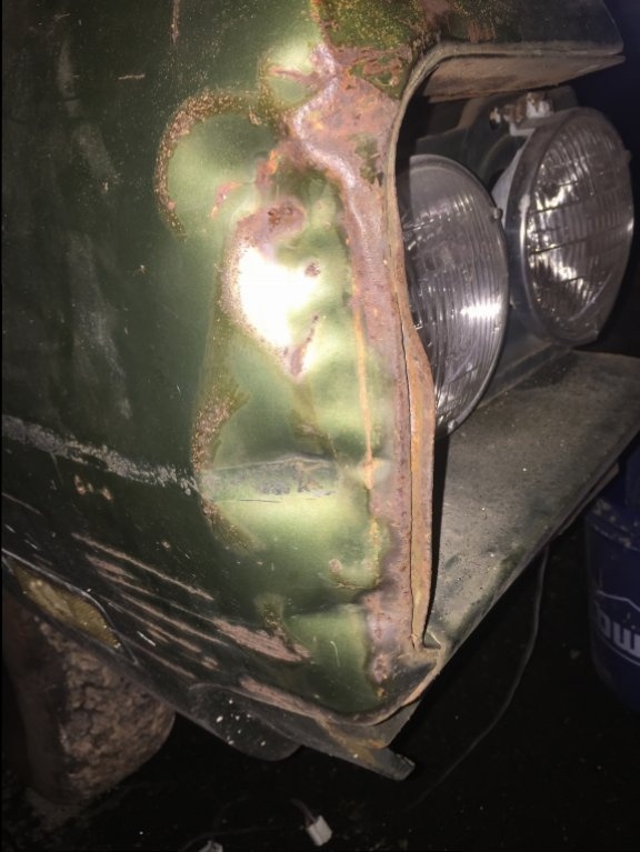

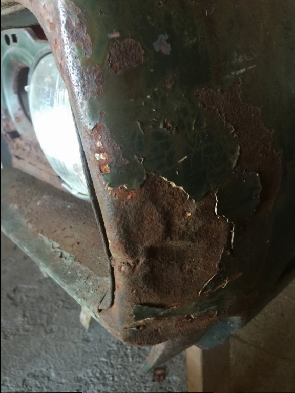

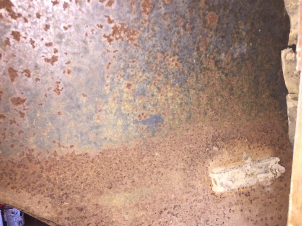

You have a pic of the bad spots on the fender?
Here are pictures of both sides damaged at the headlight bezel, the outside surface rust I've been trying to remove, and the deep pitted rust inside the fenders.
If that's the only issues with the fenders they look pretty solid. Have them media blasted and repair them they are repairable for sure.
It looks like in the pics if you blast the top of that one fender you will have holes.I would hold out for a better one.How is the area by the hood hinges?
Well, over the weekend I scored a set of really nice fenders for the car. I'll likely try to fix the originals and keep them on hand just in case.
And the area by the hood hinges is rust free on both of the original fenders.
