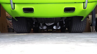

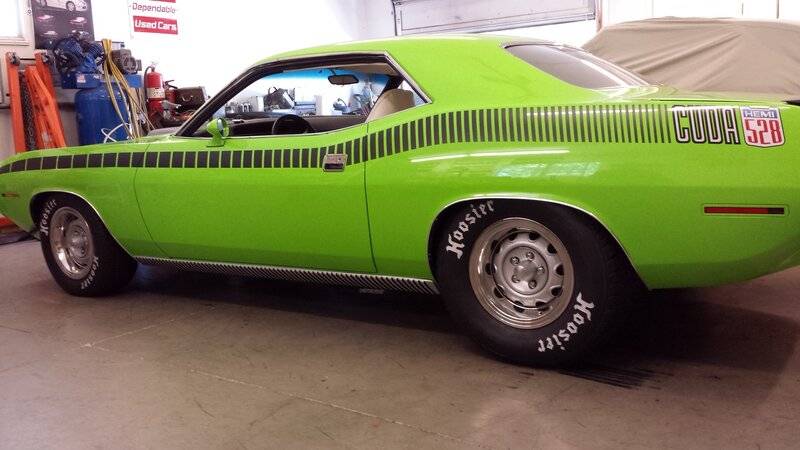

Here is an example. Had Stockton Wheel make up some 15"x15" Rallyes with 8" of back spacing. Wanted them to look stock from the side but really wide from the rear.
The first set they screwed up and had 1.5" positive offset. They wouldn't even fit over 10" drum brake let alone the brakes I was using. So they made another set with no offset and they worked great. 700.00 for a pair of wheels they had to be right.
