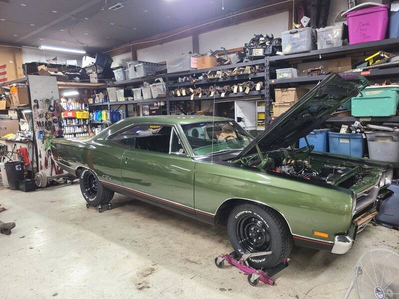

I buried my speedo with my '69 GTX. (Factory tach was showing 6g.) Thats with 28" tire 15" rim. My first GTX of very similar 440 build (a little more than stock. But still under the hood) same 4-speed Dana 3.54:1 rear. But with shorter and wider 26" 50s on 14" rim was done at about 130 MPH. (With decent drivetrain vibration.) Though not as quick thru the gears? This guy is smooth as silk at high speeds. Only signs and sounds of valve float and my fear of tire performance stopped its climb. This guy can pull away from my 10 sec index drag race Duster if given enough road. A true "Highway Star!"
Now is the stock speedo and tach all that accurate? Unknown. But calculations did put it at 140+ MPH. (If I had to dump one of these cars? Bye bye Duster. Not even a real choice.)
3.23 gears, 1:1 final drive ratio, 26" factory height of most tires in the mid/late 60's, 145 was 6100 rpm.
That sounds right. My taller rear tire does make a difference. (But also a little slower thru the gears.) I bought the car with this setup. The rally rims in the front are 14". 15" on rear. I didn't even notice until I looked at tire size. I guess the guy wanted a little taller rear stance. But didn't want to mess with springs. But I know this. It works.
