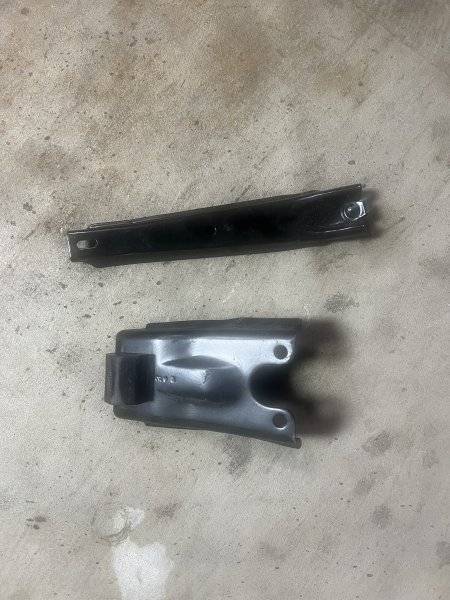

I bought a 69 GTX came with boxes of parts, and I want to know if someone can let me know where these brackets go, Thanks
Top bracket goes from core support to k frame.

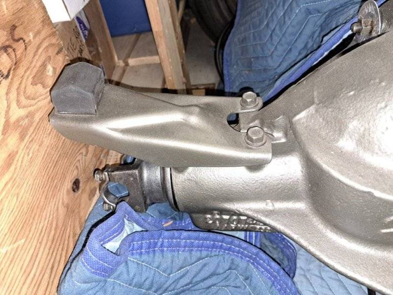

Lower bracket goes on top of the rear end housing, bumper facing the floor.
Thanks any pics of the lower bracket installed by any chance

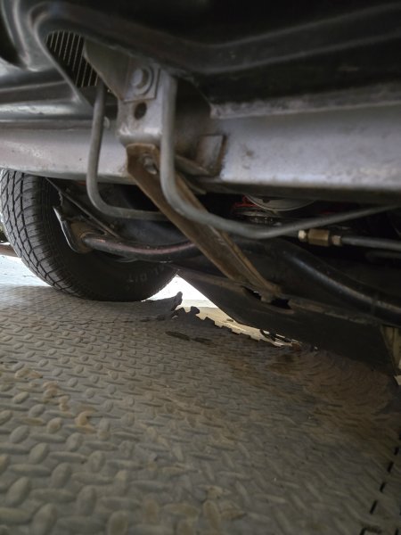

My mistake. Radiator support to k member.
Thanks I thought that was behind grill appreciate the pic. You have a pic of the other one
Not my photo...
