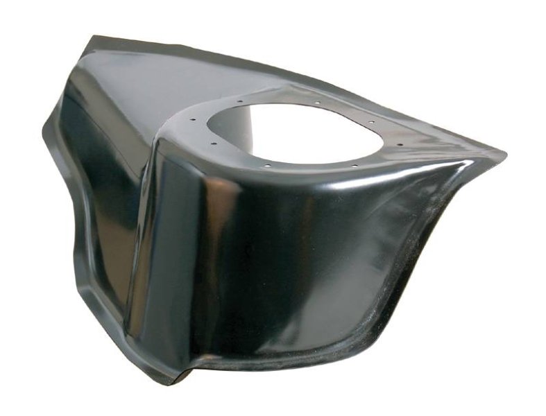

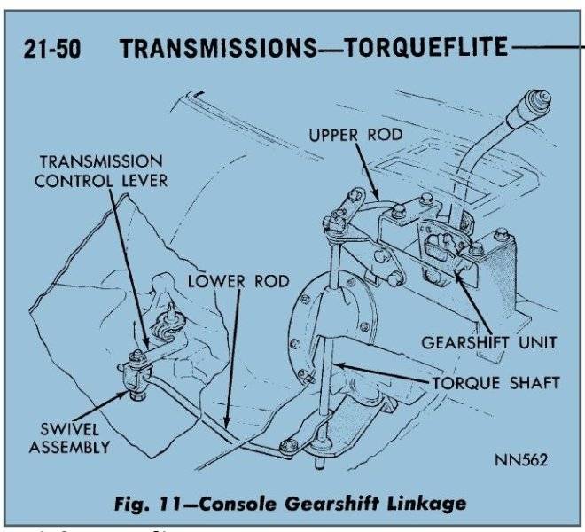

Besides the hole in the floor, you'll need the hump that fits over the hole,
the shifter to bolt onto the console, shifter linkage, floor shift style torque shaft, and if you want to get rid of the steering column shift collar you can get a floor shift version.

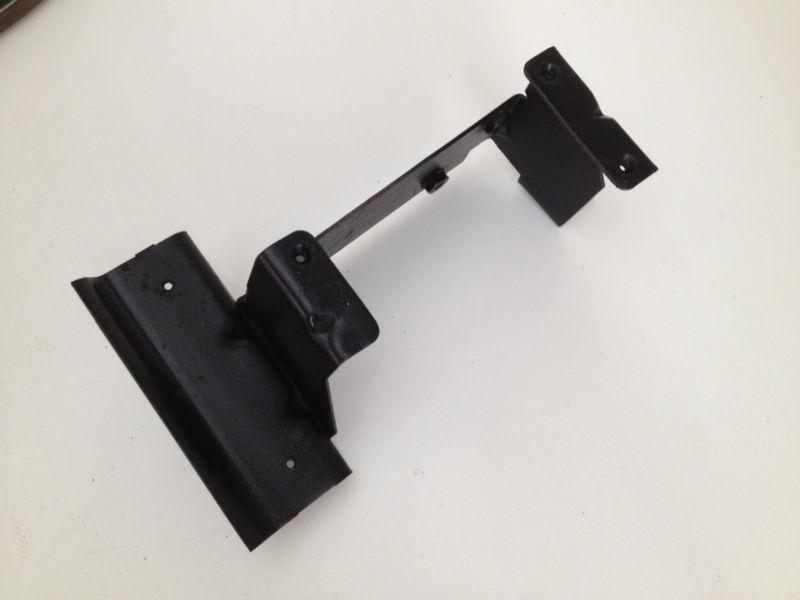

The console itself will require additional brackets welded to the tunnel.

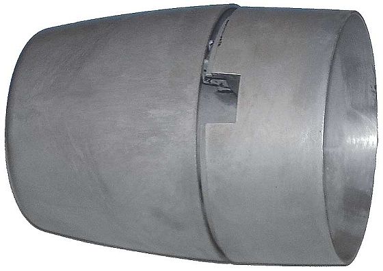

And you think I can just change the collar on the steering column to get rid of the shift indicator and lever?

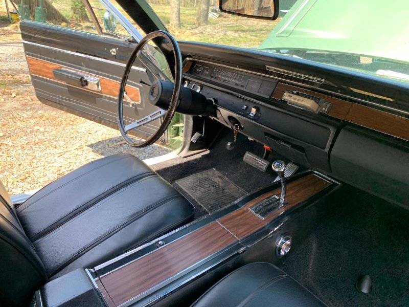

Tony's Parts came out with that collar a while back to make that possible. My former Hemi GTX was a column to floor conversion car. The previous owner who did the work changed out the entire steering column to get rid of the shift indicator and lever. Note that he used a console from 1969. Probably got a good deal on it, and he wasn't worried about originality.
