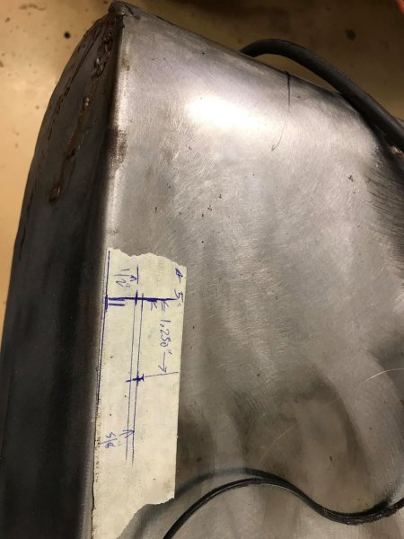

My 69 GTX came with fender mounted turn signals, but they were left off during a restoration. Is there a template or dimensions I can use to accurately locate them on the fenders?
69 Roadrunner GTX bullet fender turn signals

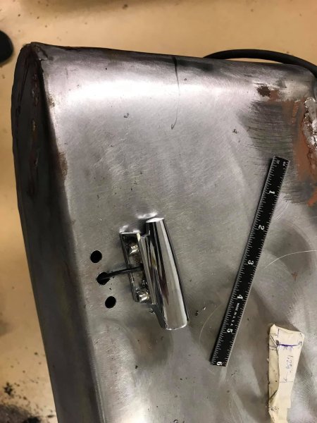

Click the link above….I used the rough measurement from this thread after validating it, and later to avoid guesswork, laid out the angle of the holes as shown.
I'm interested to know how the wiring routes to that fender indicator...anybody have a pic under the hood? Where does it branch off from the main wire group?
