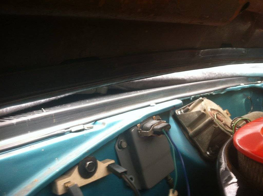

Does anyone know if the rear seal is removable and reinstallable without damage , i'm removing the hood for paint. Its got those staples.

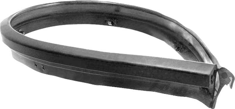

Would you have a pic of one before i attempt ?
I don't have my original handy where I'm at but this is a pirated photo from the web.

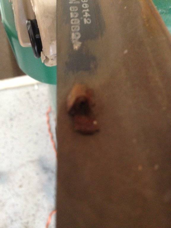

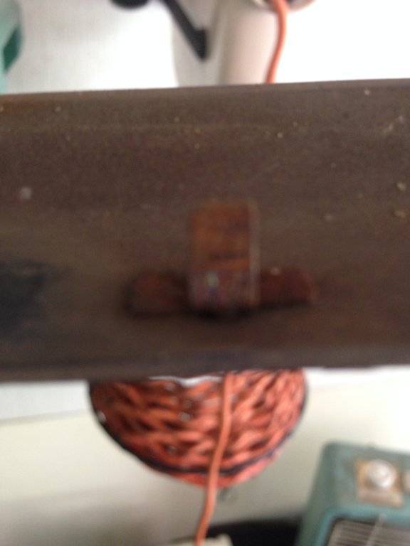

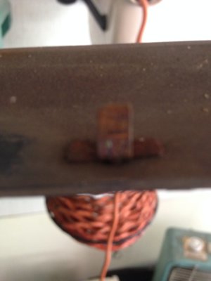

Here ya go, they're only about 1/4-3/8" high.
