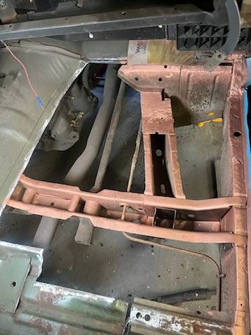

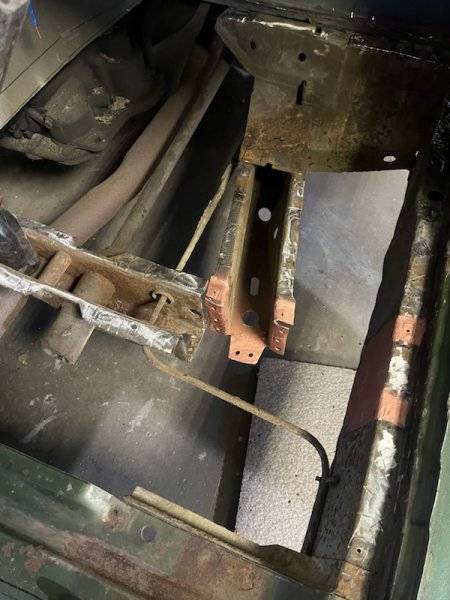

The only one I ever did was on a 67 and I had to replace the floor pan also. Not to bad with the floor pan out.
My body man had to repair my '70 Charger torsion bar crossmember when the floor pans were done. The center section was good, he just welded on the end sections from a new AMD part. I imagine he did it this way to avoid having issues with the aftermarket crossmember length not being perfect compared to the original.
