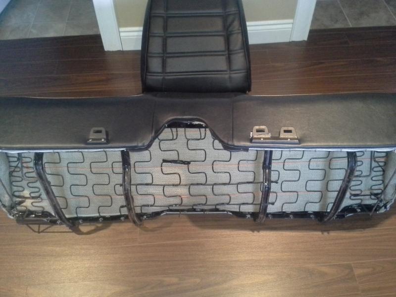

69 road runner seat belt retainer location?
Let me see if there is anything in the FSM about them. I know there is for bench seats but buckets? *shrug*

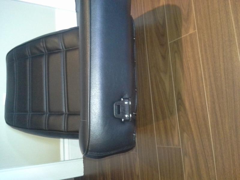

Here are the pics you are looking for, these are the seats for my 69 roadrunner. I broke the rear clip it got hit off something during storage, they are brittle, more for looks than anything
The bucket seat shown is the driver side, the clips go on the inside closest to the console. I hope this helps

Paladin, I just got on and was going to say that my FSM doesn't have buckets even shown. Glad to see someone had an actual seat to show as an example.
The rear seat has them? Who knew. 69 Coronet only had them on the front buckets. Rear seat had been recovered though.
My questions is: Are there holes already predrilled in the seat frame to accept the clips bracket?
I'll let you know as soon as mine gets out of the shop. Brackets are due in Thursday.
My seats, the ones shown, were originally tan in color and did have a set of original clips on them, I just replaced them when the seats were done. I think the retainers were original so I would say the holes are per drilled .
