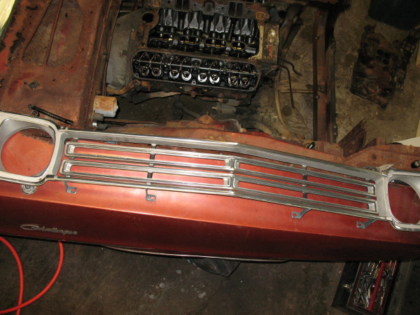

I was told This is from a `69 sport Satellite and it is for sale. Arrow straight, install as a very nice driver or really easy resto for show. PM me and Make me an offer.

Detmatt1, the grill and bezels you posted are not from a GTX/Sport Satellite, but are from a Belvedere RR.

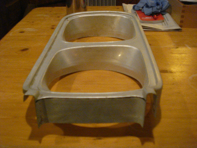

69 "GTX" and Donny ... here are pictures for comparison. The first picture shows the bezel that is used with the Sport Satellite/GTX grill

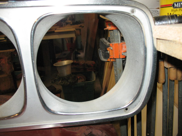

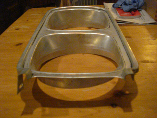

The second picture, is the Belvedere, Satellite and Road Runner bezel. Note the flange on the end that ends up on the inboard side when installed ... this is to fill in the large gap at the ends of the Grill. Mine bezels have been stripped of the anidozing and are ready to be polished, re-anodized and then taped off and painted. You will also notice that I have drawn a black line where I will cut off the un-needed material and smoothen out the the cut.

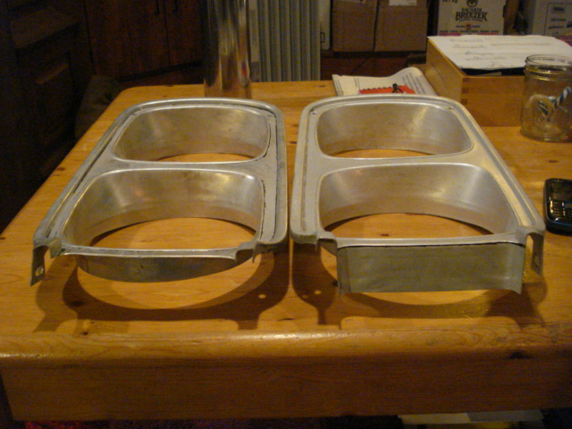

The third picture shows both bezels side by side with naturally the SS/GTX bezel on the left and the Belvedere, Satellite & RR on the left.
