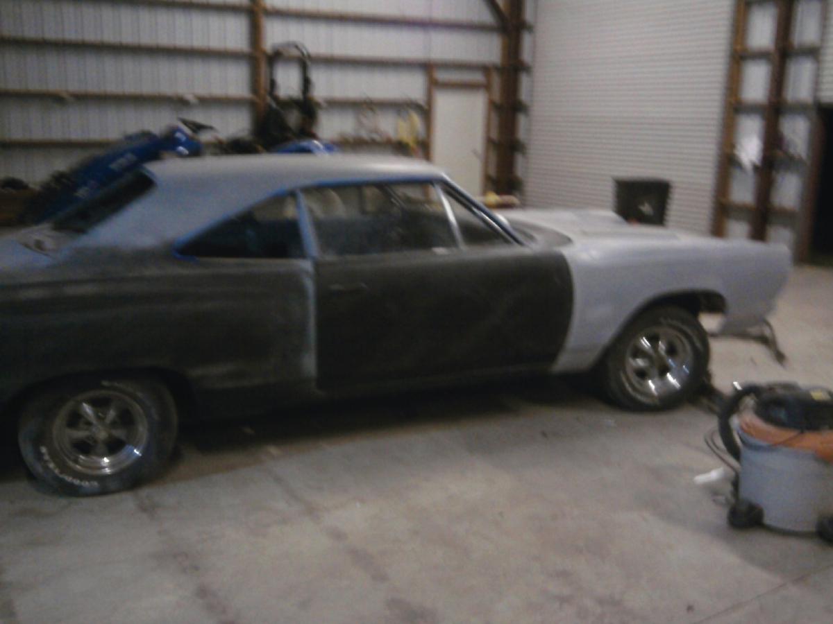

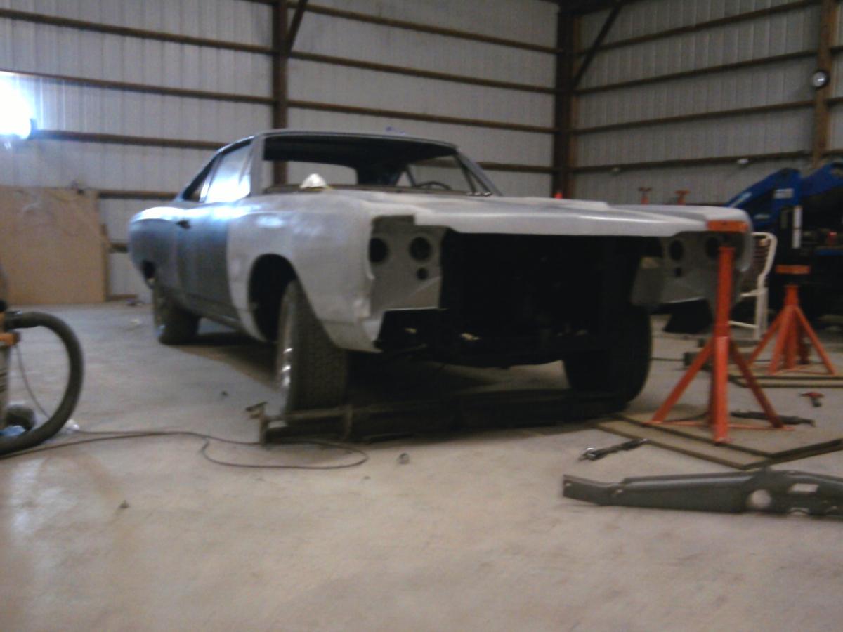

hey heres my 69 roadrunner that ive been working on for a few years. it almost burnt in my garage in 2007 but i pushed it out saving the shell but lost the original 383, front clip and some others parts. it was a 727 but since i lost that transmission i might want the 833.

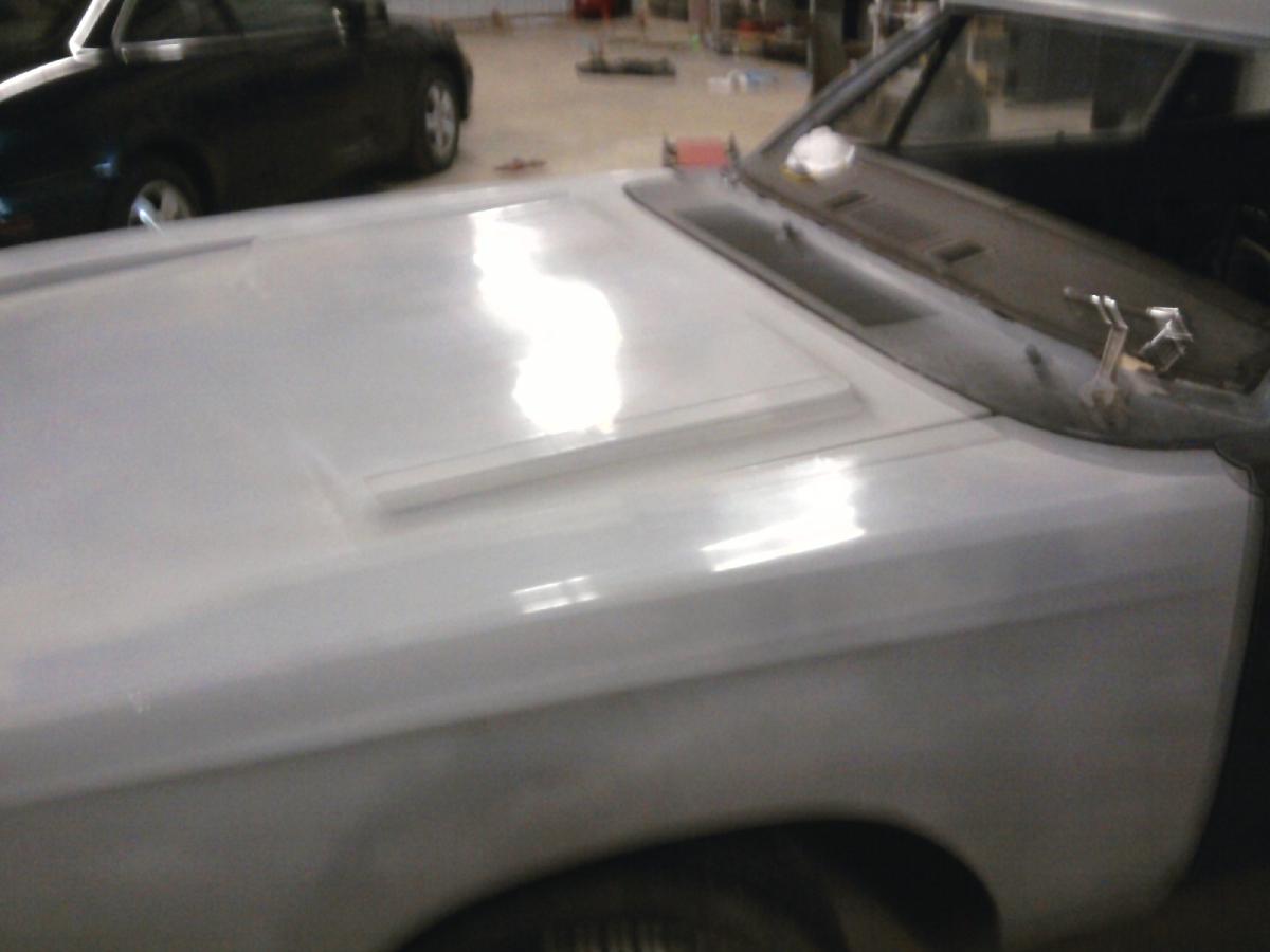

it has up22 fiberglass front end, pst bushings, kyb shocks, hochkis adjustable stut bars, firm feel stage 3 steering box, rebuilt drum brakes.
i assembled the machined block with 4.29 kb pistons .525 lift hydraulic flat tappet cam with 270in\280 ex duration, stock rods and balanced crank with arp bolts and studs. waiting on aluminum indy heads and top end.
i still need to change out the 2.76 open end gears out for posi and somthing in the 3.75 range. im almost ready for paint debaiting between orange with black hood boxes or dark metallic gray doors and quarter panels with yellow front with black boxes on hood. i have 8gs coming in afew weeks to finish this thing off so im going to need to budget this.
thanks and look forward in geting some advice
