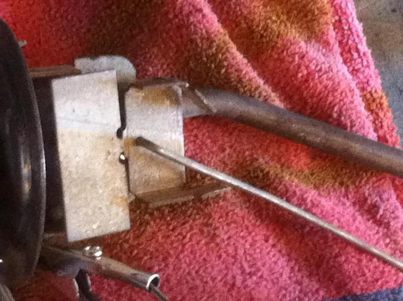

OK, have a 69 roadrunner that I can not get the fuel gauge to read right. I have the 5v to the gauges (temp works fine and so does the amp meter). the fuel gauge, full , reads about half tank. and drops fast as fuel is used. the sender is the aftermarket style, out of tank works perfect, 70ohm full and 9ohm empty. did plug sender in, grounded gender (all out of tank) and gauge works fine. . I have put an ohms box on the fuel sender wire to test gauge, and gauge works perfect, 70ohm full and 9 empty, but with the sender in tank fuel gauge does not work. have checked the ground to gauge and is less than 5 ohms. did try another after market sender , same problem. I am at my wits end over this guage and looking for help please. this is the last thing on my to do list for my friend that I have built car for (he is recovering from cancer and knee surgery) and would like to have a car like he drove back in the day. thanks in advance for any help given.

Here's what today's senders look like on the inside, they just ride on a contact point up against a wound coil (the whole thing is just a rheostat) This one had a small gap on it when it would get to the full side and would lose contact leaving the needle where it was on the gauge, bending the rod is one trick also bending the tabs on the top and bottom same thing but if that contact point stops touching anywhere inside it's over.

yep, I did that before I reinstalled, took apart, cleaned, bench tested ohms, bent the tabs to 70ohms empty and 9ohms full, ran sender threw full sweep with ohms gauge on it looking for "open" spots. even after all that still read the same. replaced sender and still same thing. but gauge work perfect with an ohms box sending the ohms to gauge threw the sender wiper to gauge. just frustrating it is a simple wiring issue and can not fine it, been a autotech for 20years, this is tech 101.. lol

This made no difference in my car, 1970 Charger with an aftermarket 3/8" sender. besides the float arm, I just recently noticed that there are 2 tabs on the sender body that limit up and down travel of the arm. They can be bent to allow a greater sweep of the arm. I'd think though that if the contacts in the rheostat don't touch after increasing the sweep, it would be pointless.
I guess it might be a balancing act. The OHMs reading of 10 when full needs to be with the float resting against the top of the tank. You'd almost need a sacrificial gas tank to know for sure that the float is right there. Cut a hole in the top and install the sender, making sure there is enough range of travel for the float to touch. So many variables here though. I would imagine that with 10 senders, you could get 10 slightly different readings. They might all look similar but could have any degree of slight mis-alignment of the sender body, float arm/rheostat body, pickup tube...
