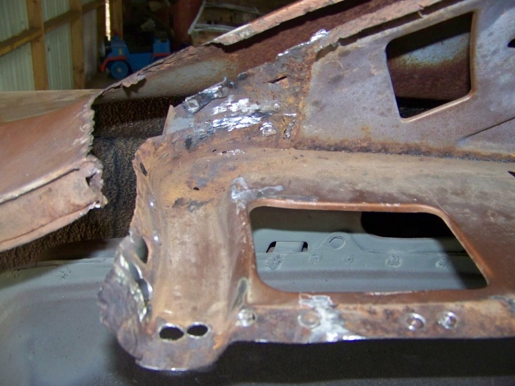

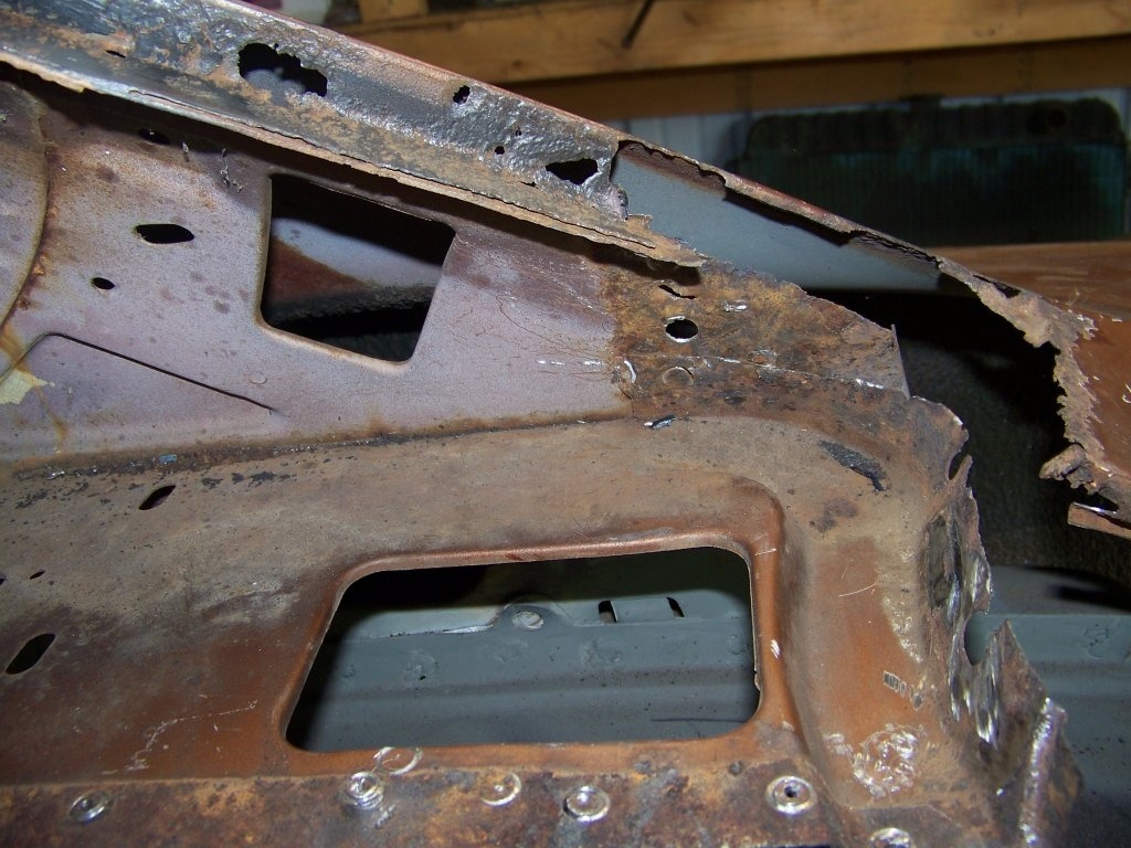

Check my bottom sig link below. I just did them on my runner.
Hey Thanks your bird and mine look like they had the same rust issues, the pics will help me out quite a bit, just what I'm looking for. Im welding my trunk pan in over the weekend, gotta weld in some metal on the package tray. Hoping to move on to these corners very soon.

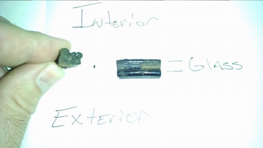

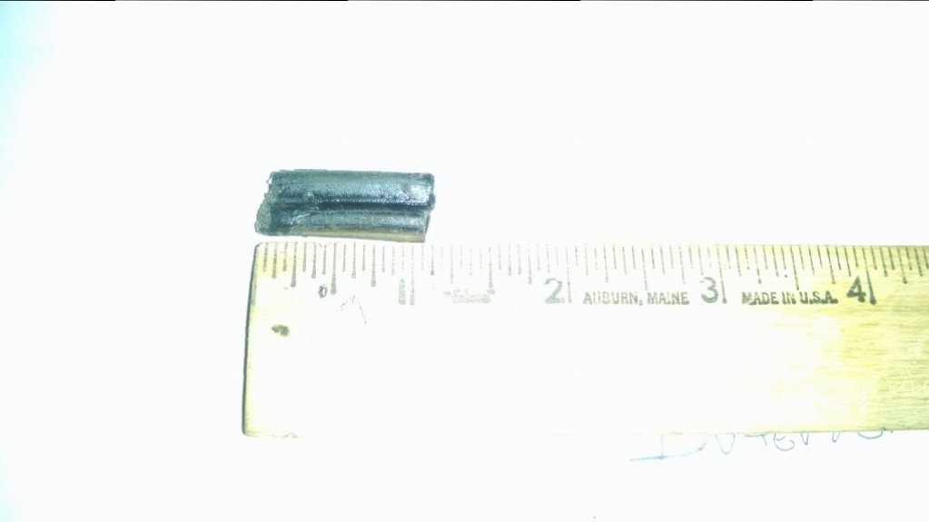

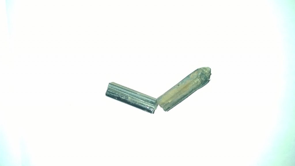

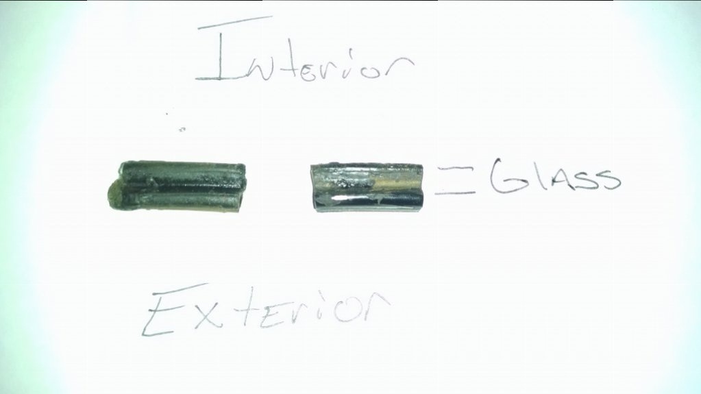

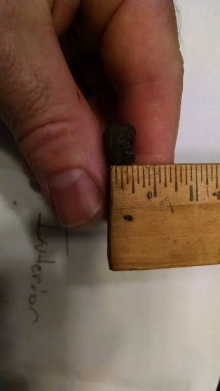

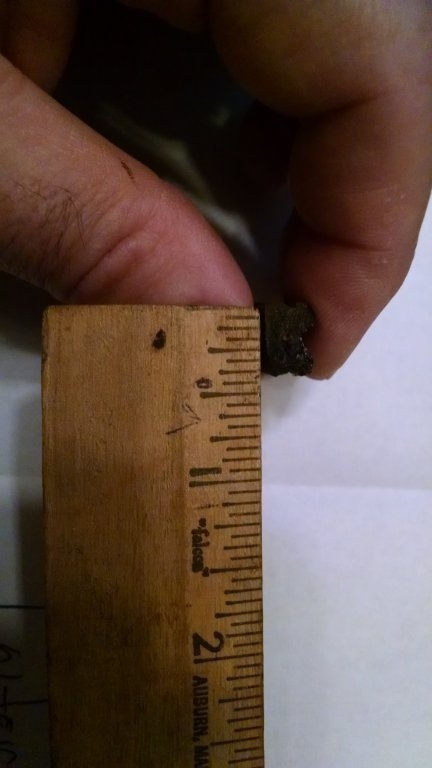

69 rr uses no gasket.....its butyl rubber caulk...has to be a certain thickness and where it seats to the glass and frame you have to use a special black primer for proper adhesion. On the lower portion of the glass the factory originally used two rubber spacers about a foot or so inward from each side toward the center. They were about 1/4 thick.
Thank You, very helpful. So it was sitting on those pieces?
Yeap....If you want I can dig up some pics of them and where they were installed...I am currently doing a 69 X so it would be the same....just give me a day or so
Please Do, I, Not in any rush my play money has ran out as Christmas and Thanksgiving approaches. Thanks Again

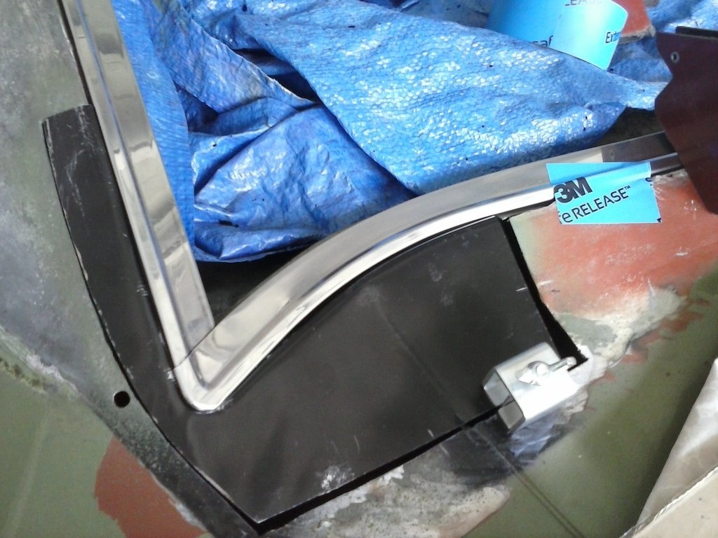

Here some pics of the window corner welded in.
