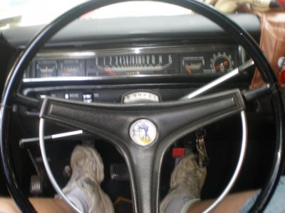

I have both and my tach works and has never been up graded , that being said My tach has never been very accurate . If you want one that works right you may need to go after market .
