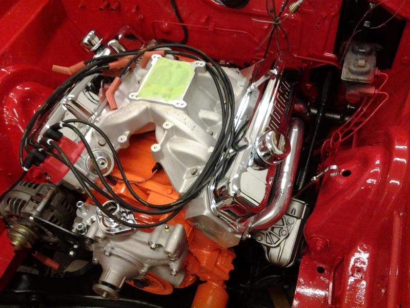

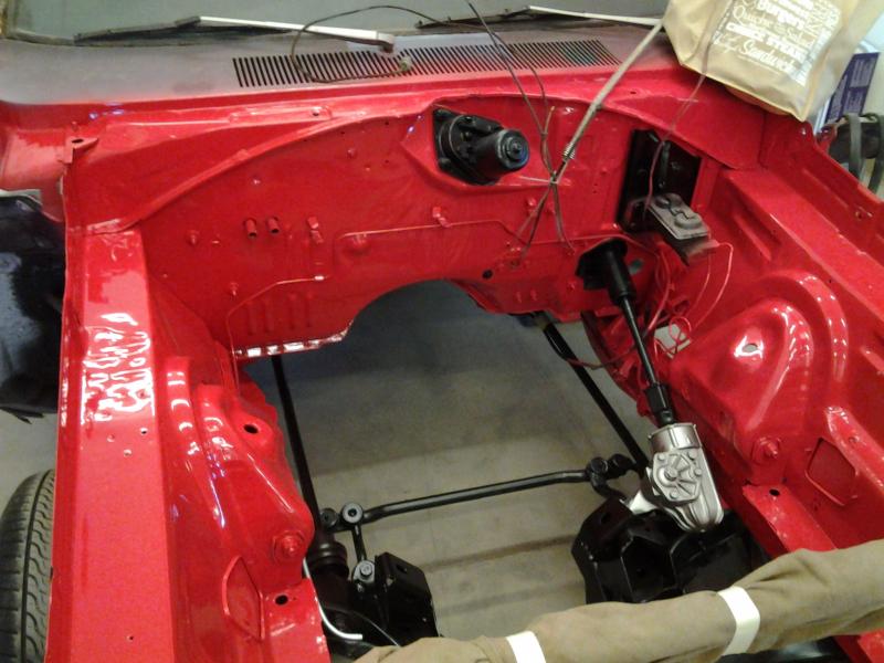

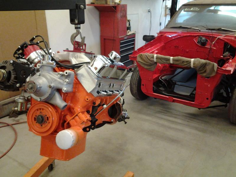

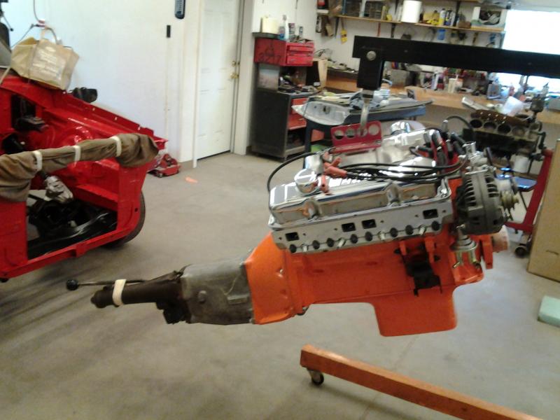

Bought the project in Idaho, brought it back to Oregon. The car had Michigan plates. Had the 440 rebuilt by my favorite machine shop, steel crank, six pack rods, roller cam, roller rockers , bee hive springs, Edelbrock top end all balanced and built with ARP fasteners. And so much more. Got the engine compartment cleaned up and set the engine and trans. in place. That left side header/starter thing was a grabber! The 4 post hoist was the best investement ever. Most of the sheet metal work is done, new qtr. Panels, new floor halves, new fenders and a hood waiting.
