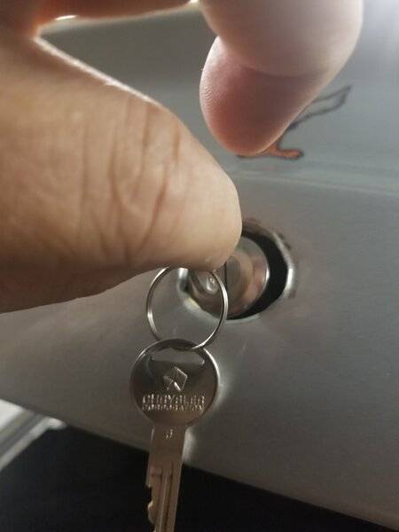

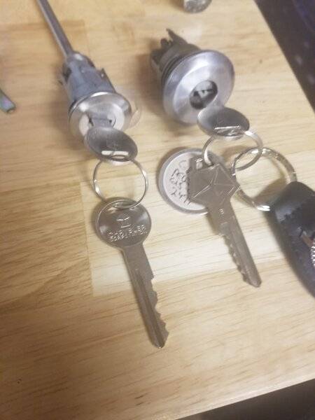

I have a 69 RR that the trunk lock broke. I purchased a new one from classic industries. The new is smaller than the old one. Makes no sense. Anybody familiar with this?

The new one looks correct. Your old one looks to be the 73 and up unit which is larger than the 72 and older one.
Looks like the lock hole has been cut out. Should be smaller with a couple square index notches.

Where is the gasket ?? Might help...... If original doesn't work because the hole is too big go shopping @ local hardware or Lowes to find a oversize flex washer.. ACE / ACO hardware has a lot of selections.

I found like yall have said it's a 73 lock. Dont quite understand why someone would change it. It must have been changed years ago because it is really old.

What probably happened is they lost the key and instead of removing the back seat to get to the latch they just hammered out the lock leaving a big *** hole. Then instead of fixing the hole they just filled it with the later, larger lock.
