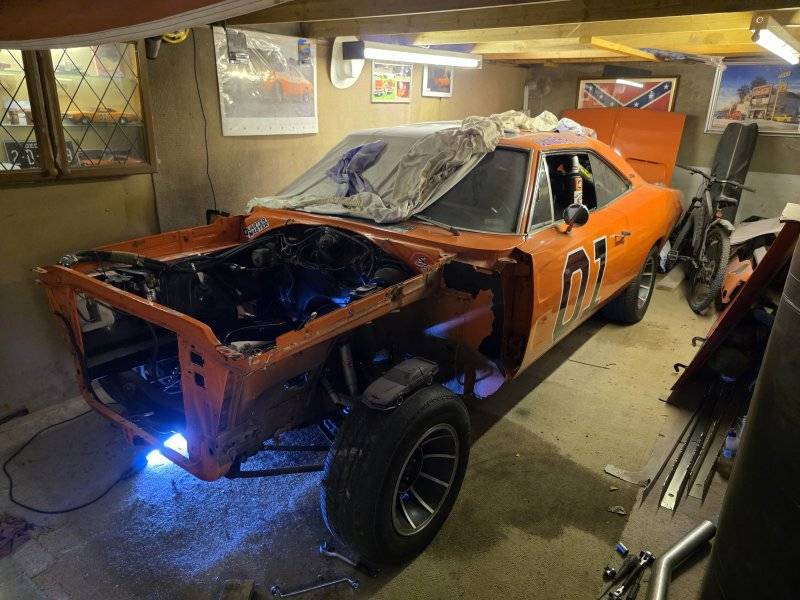

Hi folks I've gotten the chance to work on this lady or should I say sir. Can anyone give me any advice on the best measurement spots for measuring the square Ness of the chassis.

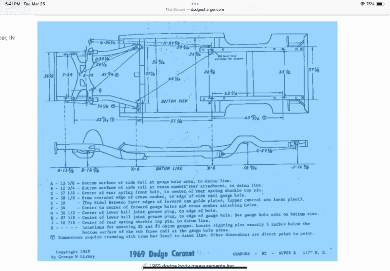

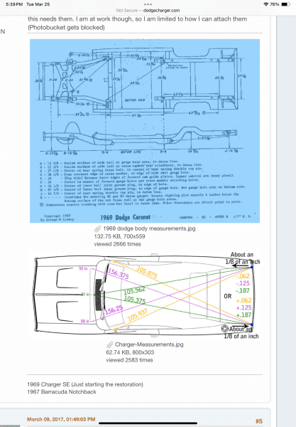

Usually the factory service manuals have chassis dimensions, elevations and squaring measurements. I know my old Corvette manual does. I think my 66/67 Plymouth ones do too but I haven’t had a need for them so I’m not 100% sure.
But I did find this with google.
Clearer image I hope.
