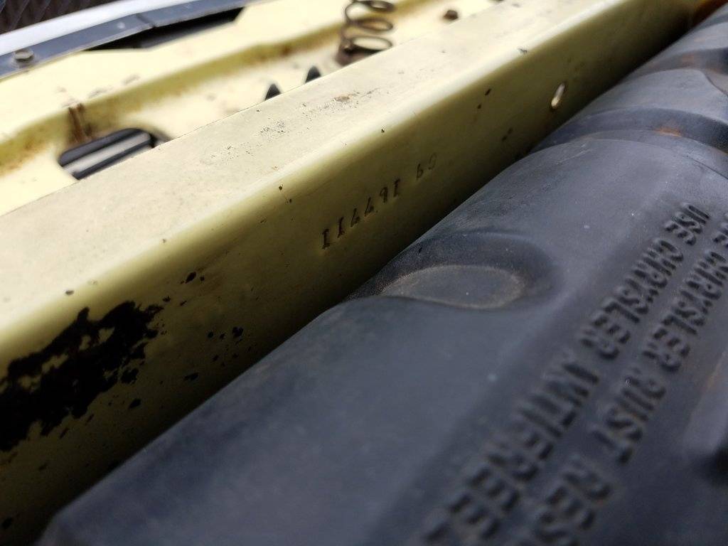

Now my question. The VIN on the dash is: WM23M9A270XXX (I substituted *** for the last 3 digits for security). The trunk stamping is: A9 280XXX. The *** digits match but the previous 3 don't (270 vs. 280). Is this correct? It seems odd one digit would be different.

I just checked again and found the number on the radiator support. It matches the trunk number so I would think this means the body is all original. Could they have made an error setting up their stamp on the line? I believe I read in another thread this was done by hand. I've held the title since '82 and it matches the dash VIN.

Likely a typo. The 270 range fits real well with an A12 Bee. The 280 range does not.
Seeing as the last three *** digits are identical it is a very strong possibility that the made a mistake and used 8 instead of seven, especially seeing as it's only one digit off.

Since both the radiator and trunk numbers match, and would have been put in with the same stamp set, I'm thinking our consensus of it being a typo is probably it. I looked at the dash, VIN tag, and windshield closely again after dinner and still don't see any signs of tampering pre-82 when I bought it. I think it's unlikely anyone did any swapping before me because these weren't worth much back then only 13 years old. I only paid $250...

Most likely typo. I've seen wrong name plates on cars from the factory.
