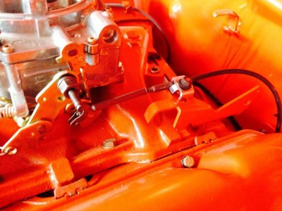

My carb cable does not align correctly.
I was told this was the correct carb cable bracket
But the misalignment makes me suspect.
Does anyone have a photo of the correct big block
Throttle cable bracket?
Thanks
That is a 440 throttle cable bracket a 69 383HP 4bbl throttle cable bracket is different

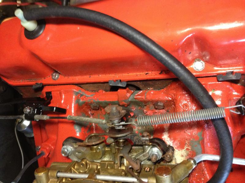

Here is my bracket. This is for a 1970 Road Runner with an original 383 and Holley carb. I had painted the throttle cable black (incorrectly), but I am relatively sure it is original. The return spring bracket, on the other hand, is not correct (but not part of your question either).
Not sure if this helps or not. Hope it does...

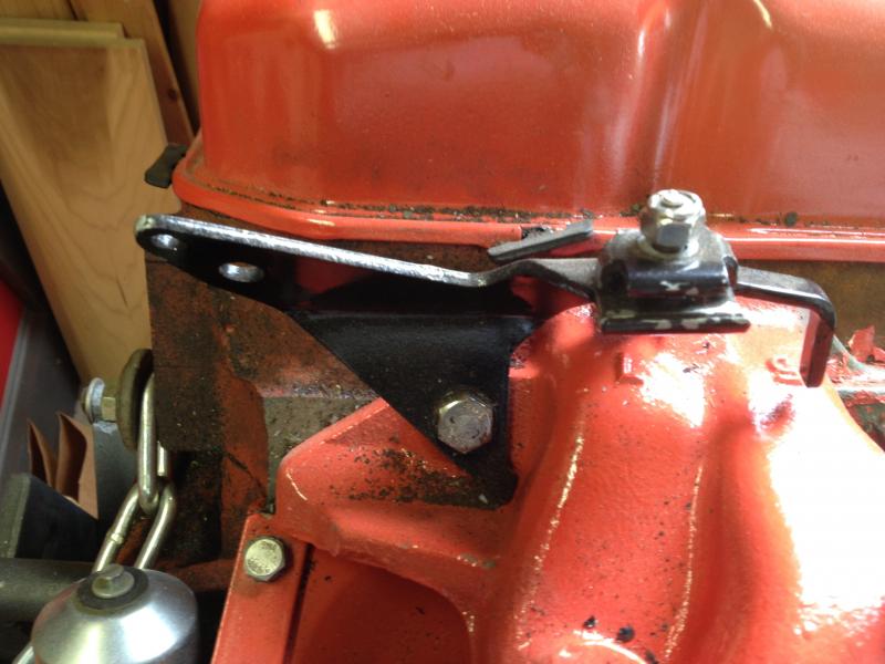

^%$#! uploads keep switching around the orientation of the pictures!!! :angryfire:
Here is a better picture of my bracket from my 70 Road Runner...
UPDATE UPDATE - So the 383/440 bracket which I have purchased and installed in the first post is for a Big Block two barrel and is aftermarket. I have found someone who has the OEM correct original bracket for a 4 speed. $75 shipped..... I feel like a hostage but need/want it.
And the $75 bracket fits worse then the other one I had.... SMFH....
I might take my original and just bend it a little to align... At what point do
you say "uncle"?
I bent the old one some... Everything lines up and fits right.. Now to get my $70 back. I'm sure he will keep the shipping.
