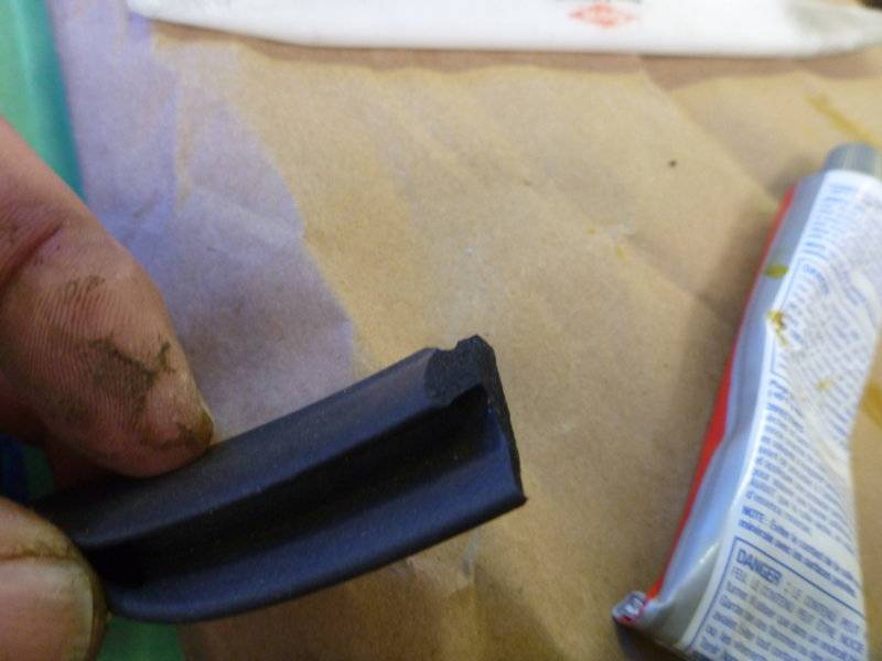

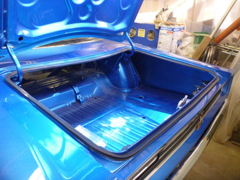

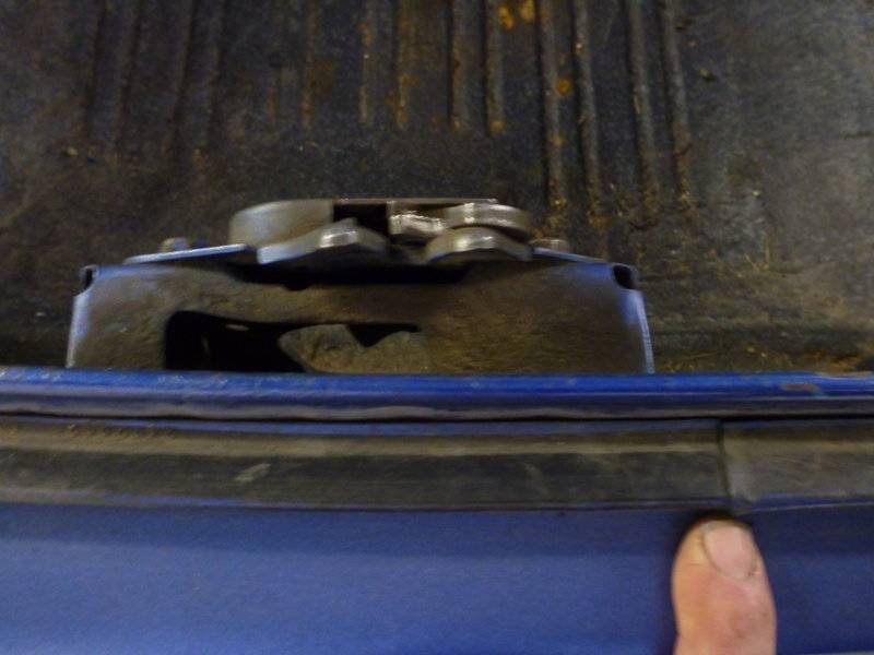

'69 bee, at least a Lynch Road car, didn't have said seal if I'm understanding your description correctly. I removed the OE off of mine during restoration and replaced it with the same shaped reproduction.
The top shape is the profile of it until right before the corners at the rear then it’s like the bottom shape around the corner and across the bottom on the tail panel.

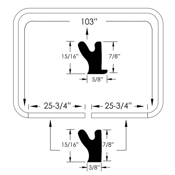

Pretty sure the ones from Steele Rubber are correct they transition to the different profile at the bottom. I threw away the one I bought from Classic Industries to get the Steele Rubber because of this.
