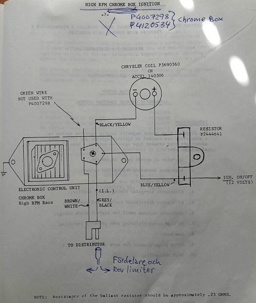

You are absolutly right.
I my case I go with the earliest info I have, the 1975 Electronic Ignition Racing Manual
