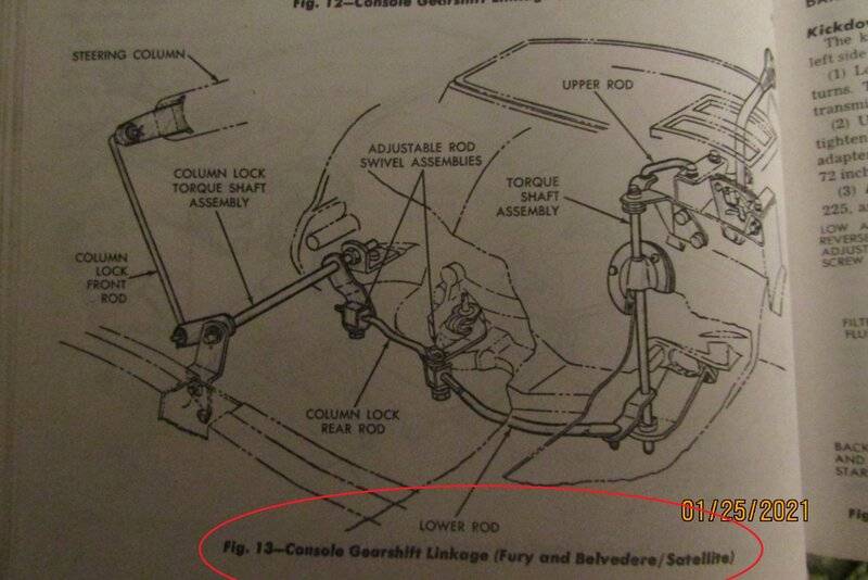

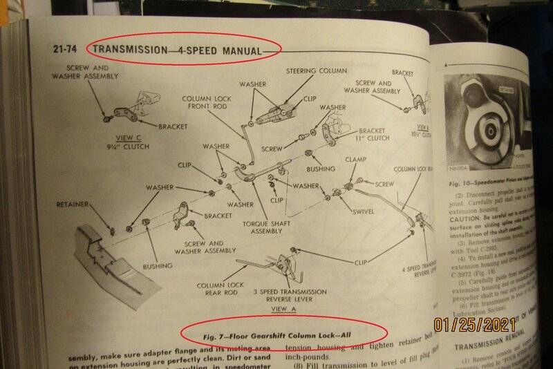

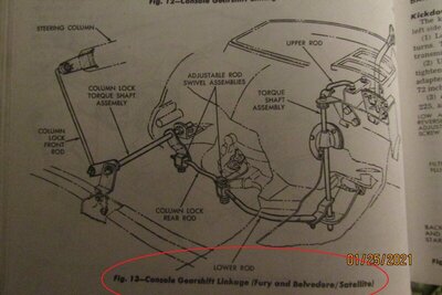

The 70 parts book and the 70 factory shop manual do not give you a whole lot of information. These are the only illustrations that I could find. The parts book mixes 3 and 4 speed parts all together. I will try to get you some part #'s. Also I been told that the B and E Body linkage is the same except the rod that goes to the column is a different length.

I see from the illustrations you posted that the bell ranks are different, like 1 wild RT said. Still no idea why, just curious. Anyone have one for pics of manual trans torque shaft or sale?
Also shows 3 different transmission brackets for the 9.25, 11, and 10.5 inch bells. I thought all BBs including hemi had 10.5 in 70. Looks different, with bends, than what’s being advertised at Jim’s, which appear flat like the one pictured for the 11” bell.
Anyone have a good pic of the 10.5 bracket? Or willing to part with?
I’ve also been told by a friend that the front or upper rod that connects the torque shaft to the column is thicker on 4 speed cars also.

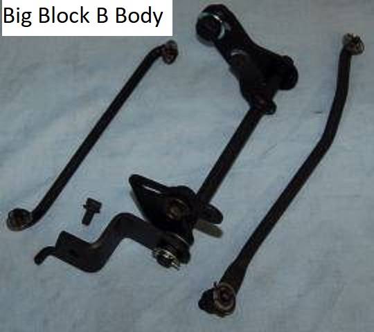

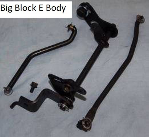

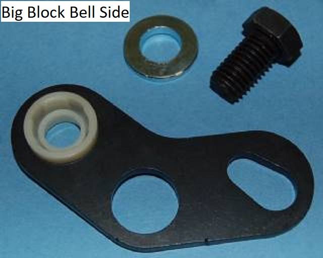

These pictures are from Wayne Brewers site. I think the parts are the same except the bellhousing mount and the rod to the steering column, depending the application.
I saw those but didn’t know if they are just like the originals.
This bracket looks like the bracket for the 11”, not like the one in diagram for the 10.5”. That one appears to have some bends, possibly for spacing it closer to the torque shaft.

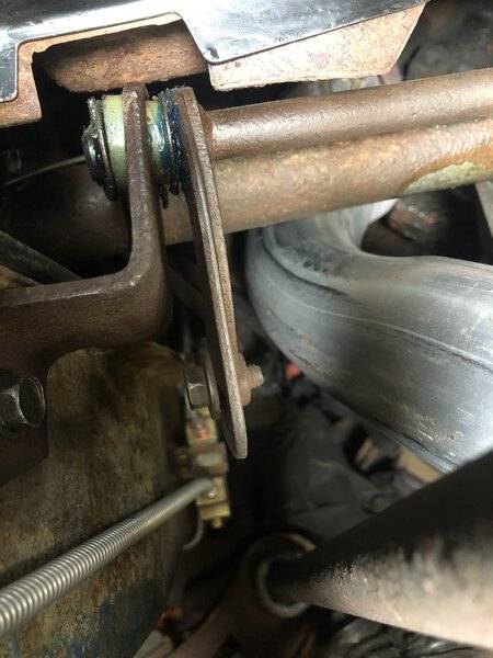

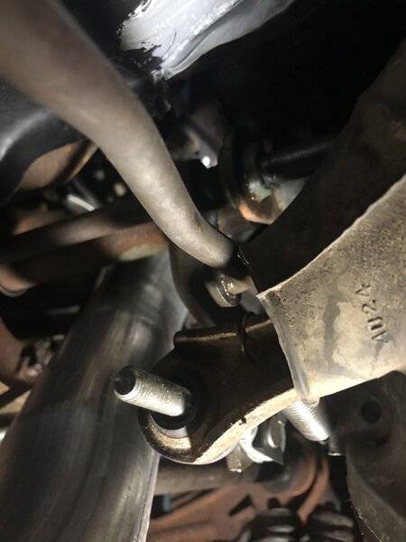

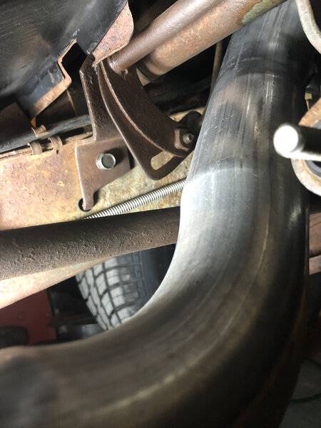

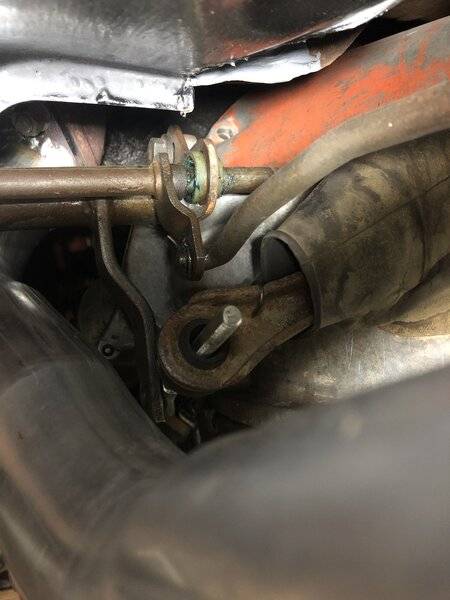

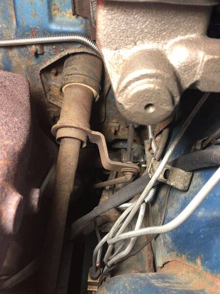

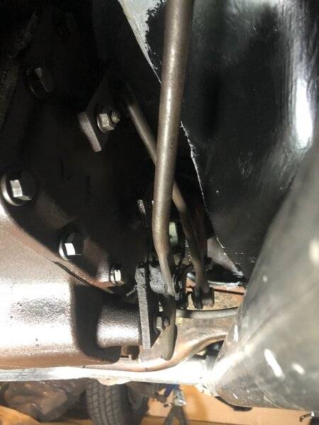

Let’s see, the head bone is connected to the ankle bone, the ankle bone is....well, just look at the pics, and if anybody has any questions or wants to see something I didn’t catch, just ask and I’ll squiggle back under and snap em!
C46F0840-8682-4762-84A4-5AFBF586E740.jpeg CFFD779E-C230-4D2A-8BC0-AE69E797B24E.jpeg 629B5D5F-D7E7-46AD-9D00-C1F2F23214E5.jpeg 42BEA674-D582-4471-97AB-ADB2120BA202.jpeg AE8752C4-A0D2-476D-AD35-37AA68CD09E1.jpeg E34DEDDC-EA8A-4969-B21D-9F0EAEDF94E8.jpeg
Great photos and thank you vary much !
No wonder these were removed so often. Man that’s some close proximity!
