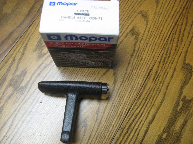

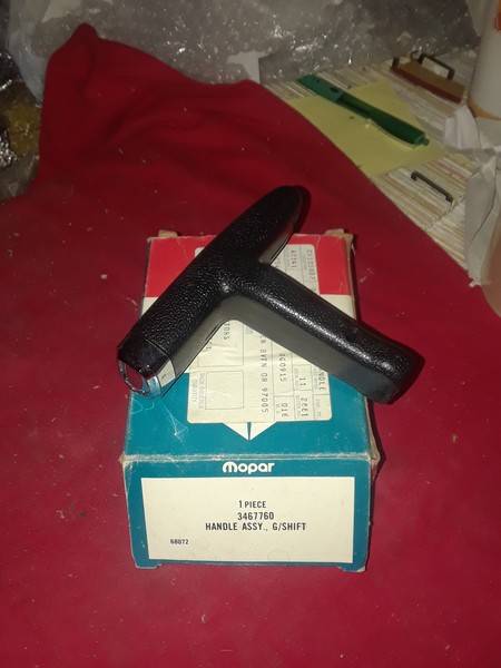

Sorry the highjack... but since has being mentioned. NOS with the fatty bottom end.
You know it's NOS due the retracted button. The spring inside makes that. Repro don't get the spring so the button keeps out. You can dissasembly it and install the spring from your old one. Even if your full buttom assembly and ring bezel is still with nice chrome, you can install them on the new repro piece ( BTDT )

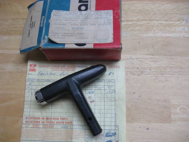

71's were straight 72-4 had the hump in the bottom for strength. They were not some aftermarket thought they were redesigned by Chrysler to address the flaw of cracking in the next model year. Here is an NOS 71 handle with the original receipt.. And a NOS 72-4 handle with the reinforced hump...
...and late 74's got 70 style.
