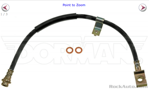

I am trying to run 70-72 b body two pin Kelsey hayes calipers on my 68 roadrunner. The calipers need to be mounted on the rear of spindle to clear the sway bar but then the hoses point towards the front and have no chance to meet up with the hard lines at the frame. I see in one post someone said to run 69-70 Camaro front hoses which use the block style connectors at the caliper which would let me send the lines towards the rear and connect with the hard lines. Anyone do this or have any other suggestions to make the setup work?

Yup I did swap the spindles so the calipers are on the rear now.....Just need to use something other than the stock style hose that is straight out of the caliper and sends the hose in the opposite direction I need to. I have the newer slide type calipers on my Charger and those use the block style end on the hose that has the brass block on the end sending the hose sideways out of the caliper. Need to find something like that for these that'll adapt these calipers to that style hose and give me the hose directing towards the back of the car and to the stock hard lines. Dr. Diff has a set of braided hoses which I wanted to stay away from but I would use if I have to, but he says they only work for 73-up slider style calipers. I wanted to make sure the camaro style lines with the banjo bolt style end on the line would thread into my calipers leak free. If so, that is probably my best bet.

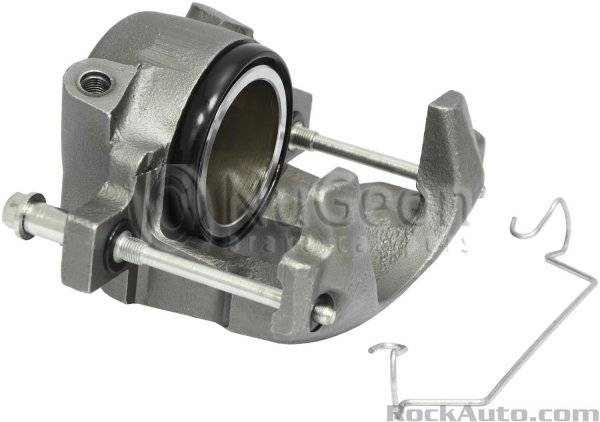

Are you aware of the 78-79 Charger/Mangnum/Cordoba calipers? They are also pin style but use a banjo bolt style hose connection...

I was not aware. I thought all the calipers after 73 were the slider type. I see a notch on that brass block end though that looks like it might seat on the caliper specifically. Wonder if it would fit on mine or leak? The Camaro one has a round little end that looks like it might fit better on there.
I used hoses for an '80 Gran Fury. Approx. length 14", banjo fitting. (Aspen spindle and slider calipers to the rear) worked perfect, no bind, no stretch. RockAuto

Yea I can check that. The caliper itself had an area for a copper sealing washer in it and used one on the screw in hose, so as long as its higher when compressed than the spot face I should be ok. I ordered the Camaro ones because the banjo joint is way smaller than the larger square brass block on the mopar hose. We will see when I get the hoses and go from there. If it really pisses me off, I will find a set of brackets for my extra set of slider calipers for my Charger and mount them on and say F these pin type models haha! Bought the package from a buddy with the spindles and all so trying to use the complete deal, but I will only go so far before I say this blows and take a different approach.

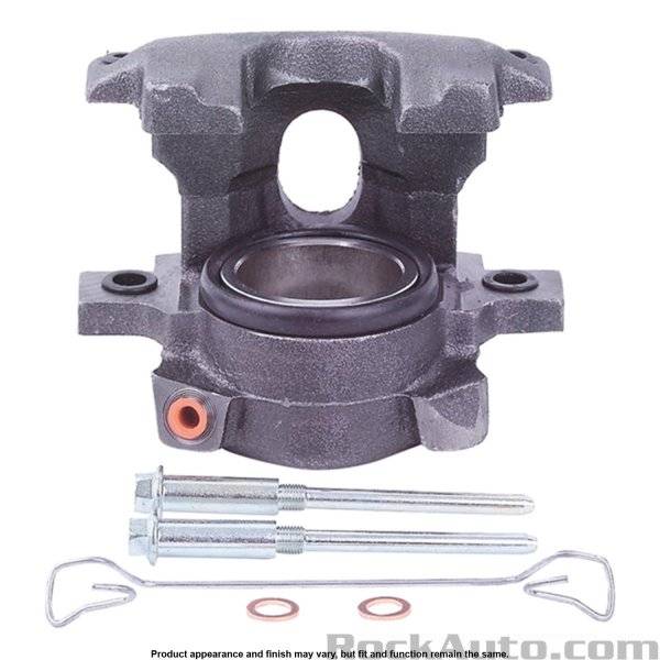

Looking at the picture on rock auto of the caliper, it looks like my washer should seal ok with almost no spot face on it and nothing in the way of the complete flat mounting face.

Yep they worked out well so far. Seem to have enough length to not bind and don't rub anything.
