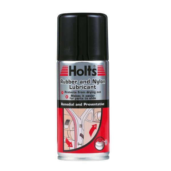

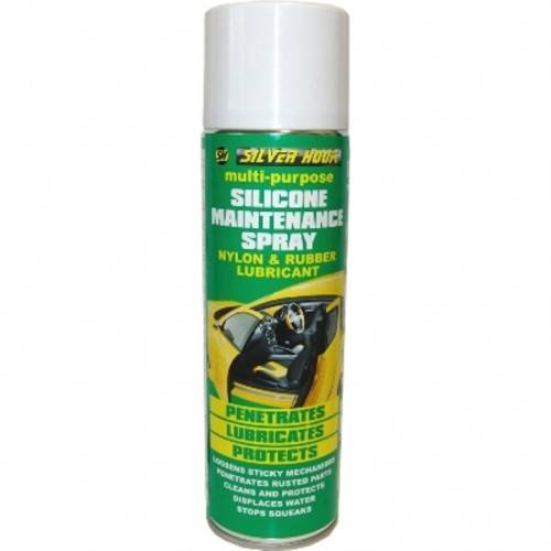

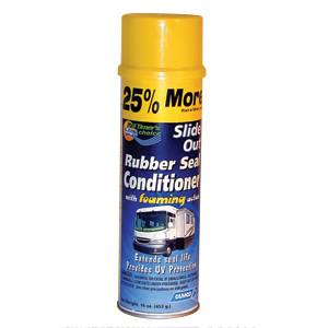

Rather than oil, I would use something specific for lubing rubber.
Great thought and that makes great sense

Just an update for those that are curious:
Per Photon's recommendations, I purchased a silicone lubricant that was safe for rubber. I sprayed just a little bit into each port of the vacuum canister and worked the mechanism back and forth. I definitely think it improved the operation, because it seemed less "grabby" and more smooth right away.
I still can't say that my Air Grabber opens very quickly, but I think it is as good as it's going to get.
