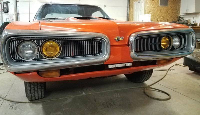

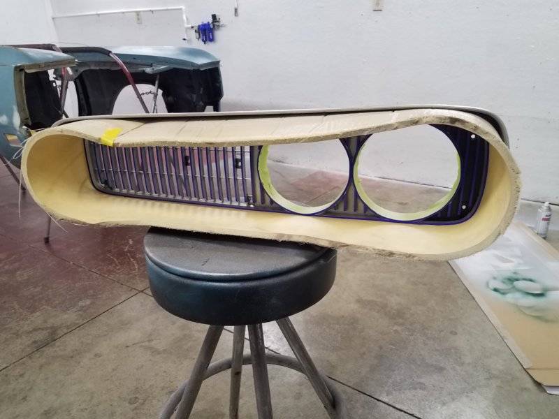

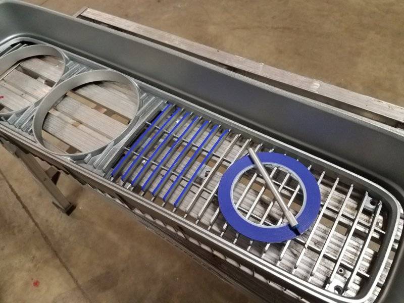

After the all the repairs, about 45 min each and some serious patience with the fine line tape... I was able to save original grills. Not sure if the color scheme is 100% correct. Black over argent silver

Cracks on the outer rings of them and a couple vertical bars were cracked and or missing.
What did you do to make the repairs? I have a couple I need to address on my '70 Super Bee. Thanks.
For the vertical slats that were missing, I took them out and shaped them off a donor grill from another vehicle., then plastic welded them in, the cracks on the outer ring I plastic welded them also. For plastic welding, i will use a stick style soldering iron and some same style plastic as filler material.
"rlem1977, post: 910923350, member: 28718"]What did you do to make the repairs? I have a couple I need to address on my '70 Super Bee. Thanks.[/QUOTE]
