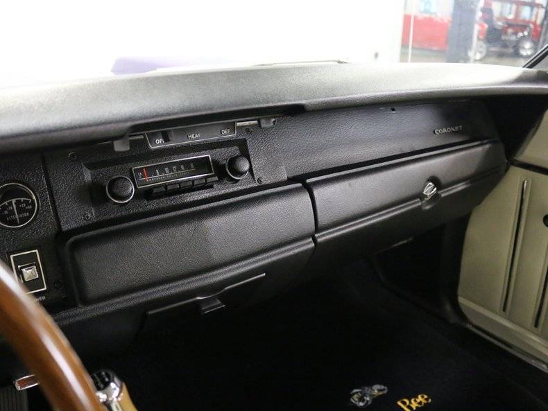

So I was looking at this Bee and I think its a clone,am I wrong? 1ST coronet on dash and black dash 2nd air control on drivers side and 3rd top of inside doors painted white.
https://www.allcollectorcars.com/for-sale/1970-Dodge-Coronet-Super-Bee/2170047/

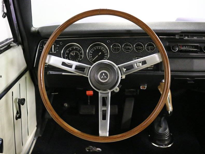

Rally dash wood grain no coronet on dash, fresh air next to reverse light I believe
VIN assuming it belongs with the car is WM...
My buddies 70 Bee had the black rally dash not the wood grained dash... But it had a Bee over the glovebox.... What would use a rally dash but say "Coronet"?? Not a Coronet R/T... Getting the "Fresh Air" pull in the wrong place is an easy mistake if a non-mopar person was involved in the resto....

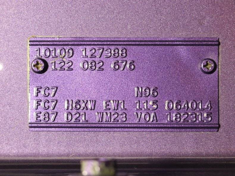

EW1 is white upper door panels???
Yes that is the white upper door frame paint code on the fender tag. Will be same on all of them Lynch Road or others.
On the build sheet It is under UDF color line on 2 near the center. Between interior code and exterior paint code..

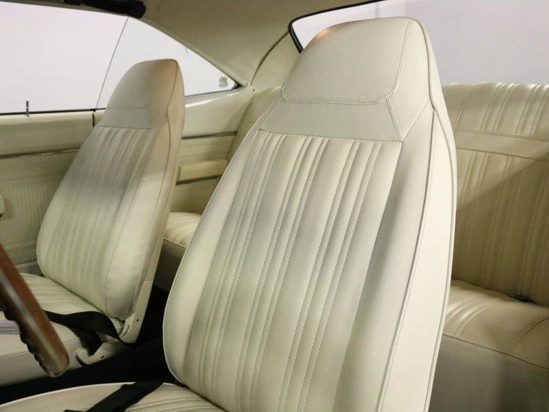

Never say never/always in the mopar world, but the possibility of an original Coronet glovebox bezel and non woodgrain dash in a 70 Bee is very low. More likely, the entire dash was replaced. There is an AM radio, but no radio option on the fender tag. Interior looks correct for H6XW. As noted, incorrect later 70s wiper motor. Overall looks like a genuine V Bee, but at their price I'd want to do an up close and personal inspection.
No radio codes on a Lynch Road Tag. I would say somebody didn't like the woodgrain facia and simply swapped the bezels for a more appealing look. A you can see, the over glove box part doesn't even match the other Rallye Dash bezels.
Sooo...I guess I'll be the first to point out this is a bogus tag containing at least four errors.......
