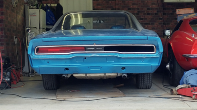

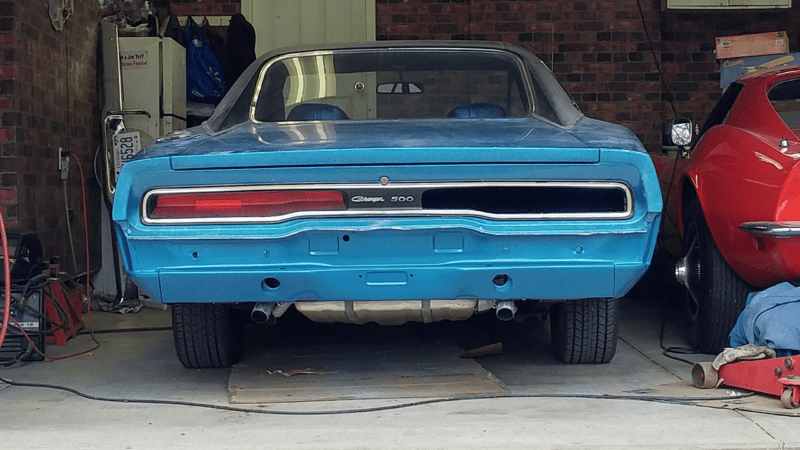

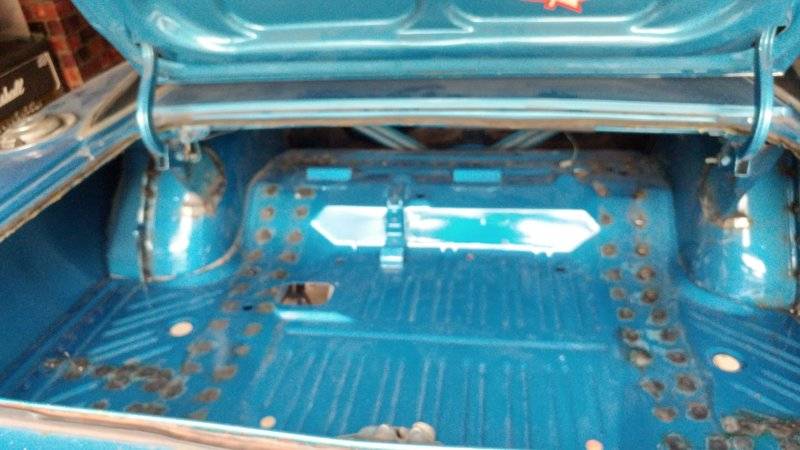

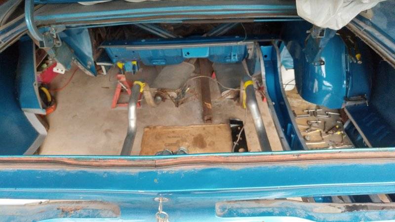

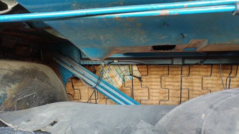

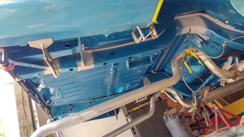

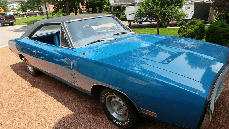

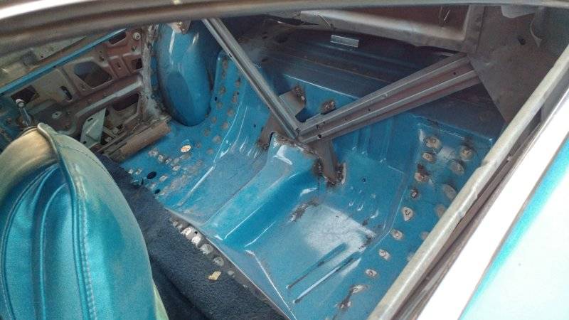

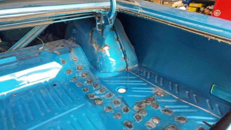

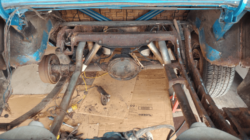

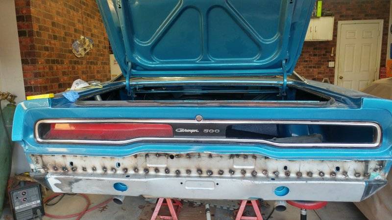

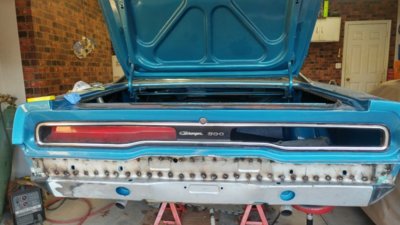

I'm in Niagara Falls, Ontario. I picked up this Charger a little over a year ago with 71,000 miles, pushed it home with my friend and son, entire undercarriage rotted from sitting, I spent three months on my back in the garage putting in new metal from the front seats and back, 14 pieces in all i believe.
I used all Goodmark metal which all seemed to fit well and resemble factory, except one pan drop off by sherman that appeared to be cut with hand shears.
I did this a little different, painting panels first, than re shooting welded areas and recoating.

Sweet lookin 500! Great job saving it from a slow rusty death. What a great bonus to have the build sheet. What are the options it came with?

Welcome! Nice work. I love seeing another old B-body saved!
