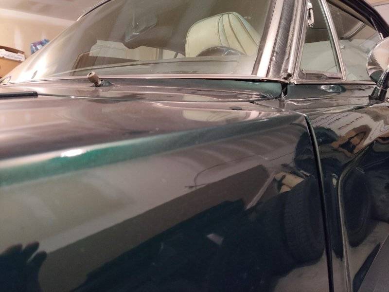

Your left front fender is low. That should be raised first. The trunk is a pain. They never fit perfect from new. If your trunk latch cant be lowered you may have to slot it a bit. Is your trunk seal in place?
I have a new trunk seal installed. Thanks about the front fender, I don't recall it being low relative to the hood before it was painted, and the panels weren't removed for painting, so I'll have to take a closer look at that. The trunk & hood were removed though.
EDIT: I'm pretty sure my left fender to door gap is perfect, so unless the leading edge of the door is also low, I'm guessing the issue is just the hood. Both my door gaps look perfect. I need a closer look at that cowl...:rolleyes:

I agree the one fender looks low.

This looks low to me. Get it up to cowl height where it should be. Your hood will be closer then.

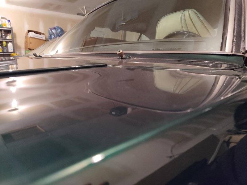

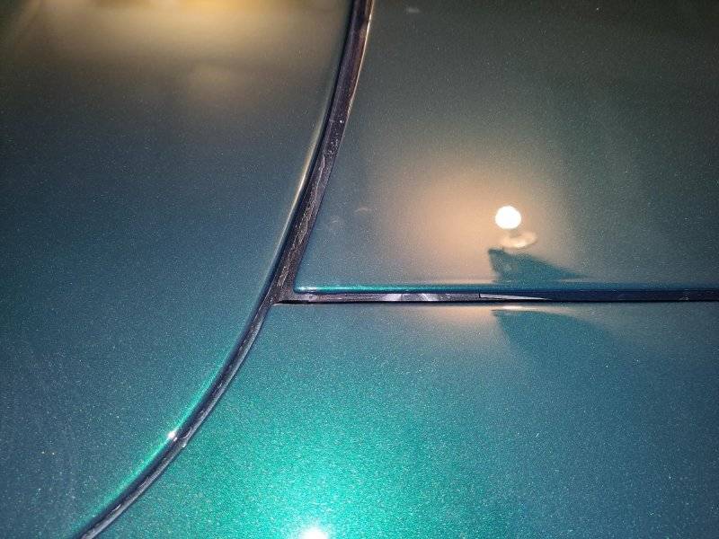

As I remembered, the cowl, fender and door are all perfect. Digital images and perspective can make things look different, but as these pics show, only the hood is high. Everything else is good.
I installed new rubber bumpers and got the front of the hood also lined up perfect, height-wise, with the fronts of the fenders. Will need to tackle the hood front-to-back and driver side height next.
