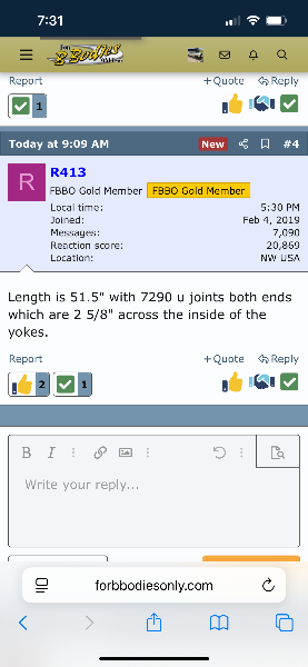

A buddy was asking and I remember seeing a chart but can't find it. If someone can post a chart I will make it a sticky to make it easier for next tome. Thanks.
70 Coronet 383, auto, 8 3/4
I found this one.
Mike o believe this is it from one of my many subjects I’ve saved here
