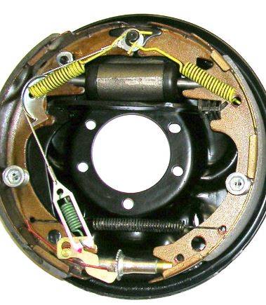

I'm doing brakes on a 70 Plymouth with a a Dana rear... it's missing the levers that hold the self adjuster wheels... nothing in my stash of 8 3/4 parts seems right... anybody have pics of what I need? The FSM pic isn't much help....

What size brakes? 10 inch brakes with self adjusters are the same, I believe. Same for 11 inch but you can't mix them. Some cars with HD 11 inch brakes come with manual adjusters. Picture is 10 inch off dr diff website. Edit: Right hand side.
My Dana was missing the levers for the self adjusters too, but it was because they were never there and it has to be done manually. The field manual shows both versions, with and without self adjusters.
Manual adjuster have course teeth. Never counted them but 12 teeth? Self adjusters fine as in pic.
Also manual adjusters have coarser & fewer teeth.
