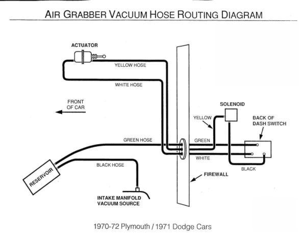

Here is a diagram which I saved a few years ago...it should help as long as you have the original colour-coded hoses...
Good luck. :thumbsup:
Thank you for your information....I could not find my copy of the same in time to post it. I did make a schematic diagram of the hose connections and components using ISA (Instrument Society of America) symbology. Unless the reader understood ISA symbols it would be confusing, so I did not post it.
