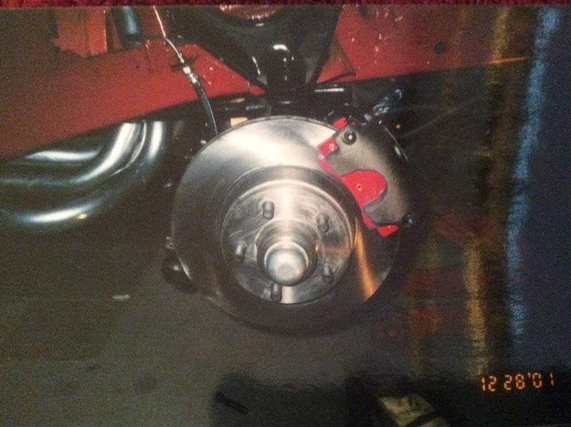

Finding the pin type caliper brackets for 11.75" rotors is hard and expensive . Kits are the way to go. Did the "Disc O Tech" conversion in 2001.

Dr Diff is the best for the money here
