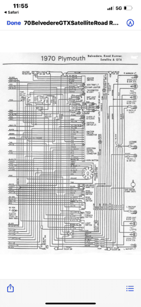

I took out my old wiring harness that burnt up and when I went to put the new wiring harness back in so.e things just don't look the same, but I'm trying to get it right. Does anybody know what this box is? It was attached to the top of my glove box. I can't find it on my electrical diagram.
It is for the 8 track stereo R22. It is the wiring for the 3 speakers on top of the dash. It is in a separate wiring diagram.
‘70 GTX
Whoa that’s cool ! Nice color wiring diagram
I didn’t see it here either

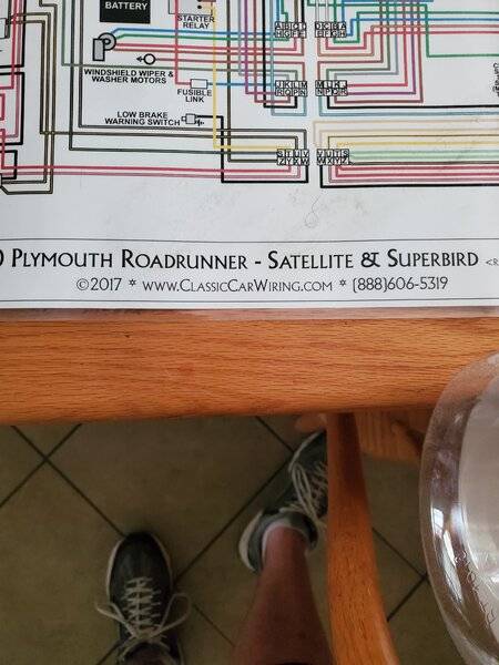

Wow I knew the car was born with an 8track but has been long gone before I got it.
Thank you very much for that info R413
The diagram was pretty cheap and was here in 3 weeks. The number is in the pic
