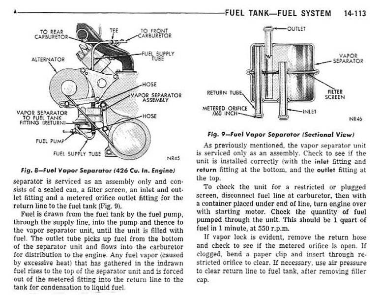

Anybody know how the fuel vapor separator plumbs. I believe the out Port goes to the vacuum Port on the carb. There are 2 other ports one smaller than the other. Is it as easy as connecting the smaller hose from the tank to the smaller port and the same for the larger hose?

The "out" port will go to the fuel inlet of your carburetor.
The smaller of the two remaining is your return line. The other is the feed line from the gas tank.
It's meant to be inline with the fuel system between the pump and the carb, using a (1/4" usually) return line to your gas tank...nooo don't hook it up to your vacuum port
