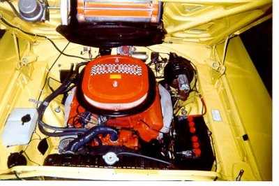

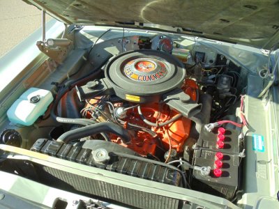

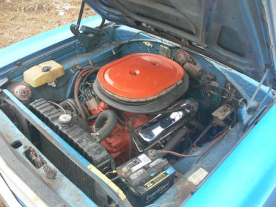

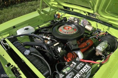

That is about where mine are but I have two regular horns since mine is a GTX. Anyone with a GTX have any pics of your horns?
the last photo of the B5 blue is a GTX ,don't no why he added a RR horn ,but the other one it looks like he painted it blue ,I'm still looking:parts book:
1970-GTX-3[1].jpghere' three more GTX's
How did you run your harness? It should run across the intake to the alt. then over to where you horn is bolted! BTW yours is a dual horn setup! Pictured is a RR beep beep horn!
steve I posted some photos up for him some where RR's and a few where gtx not sure why some had added the RR horns to theres

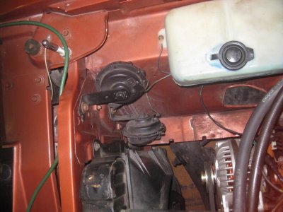

Mine comes out of the harness at the alternator green with w/ red tracer and has 2 connectors for the horns the other wire is brown and is for the washer motor.
Hope this helps.
