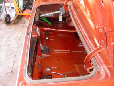

I have lived in Western New York my entire life, and I have seen some pretty darn nice cars that have always been in the area. Don't get me wrong, I've seen plenty of rotboxes, but there are cars that have been well taken care of in the northeast.
I agree... Actually, the cleanest car I evern owned came right out of Buffalo, NY. In fact, out of the 100 plus Mopars I have owned, the cleanest ones were from right here in NY/NJ. Of course, I have lots of rust buckets from here as well. The one car I got hosed on, was straight from Phoenix, AZ (sold brand new at Bill Luke, CP in AZ) More rust and damage than I bargained for for a "desert car". All said, it all depends on how the car was taken care of and stored through its liftime.

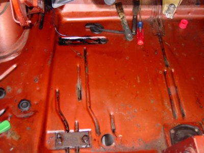

Trunk floor of the lifelong Buffalo, NY (THE RUST BELT capitol) '70 'Cuda I owned. You won't find them nicer, that's fo' sho! Oddly enough, the car is now in SoCal!

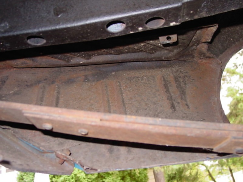

Back on topic, also look for sneaky rot in the lower door hinge boxes, the front and rear rails, especially the torsion bar crossmember ends by the rockers.

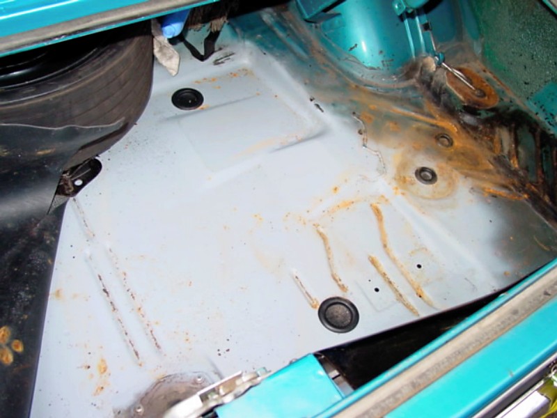

Here is a super nice, rust-free trunk floor and left extension (whole car was rust-free) from a bought new in MI, then to PA and finally to me in NY (AAR 'Cuda). Point is, don't discount any car because of the region it is located in:glasses12:

@RubyRedSavoy- that was my point exactly- each car is taken care of differently by their owners and will age differently. I know Buffalo is the rust capital, but I have seen pristine condition survivors in this area. Lots of people put their muscle cars away and had winter cars to drive in the salt.
