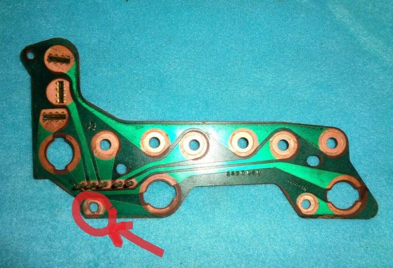

That does not make sense. His gauges are working but loses them when the dash lights are turned on. The lights are taking the ground away from the limiter. He needs to verift a ground at the board. My bets if he installed a auxiliary ground to the board at this screw the problem would be fixed..
