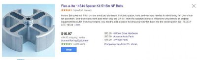

Hi, wondering what you ended up doing. I have a 68RR and have 26" radiator and a 22"shroud (obviously wont fit together). So i have the option of making the 26" radiator work (by ordering a shroud and cutting the support panel, drilling mounting holes to center it) or order a 22" aluminum radiator that is around $200. My roadrunner has a 440 in it and has had overheating problems in the past, but its been 12 years ago and I dont recall ever figuring out the cause. Also I have a flex blade fan, with no clutch, do i need to put a spacer in there, to get the fan closer to the radiator? lots of questions, im disgruntled
