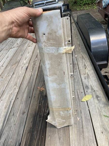

Hey Guys,

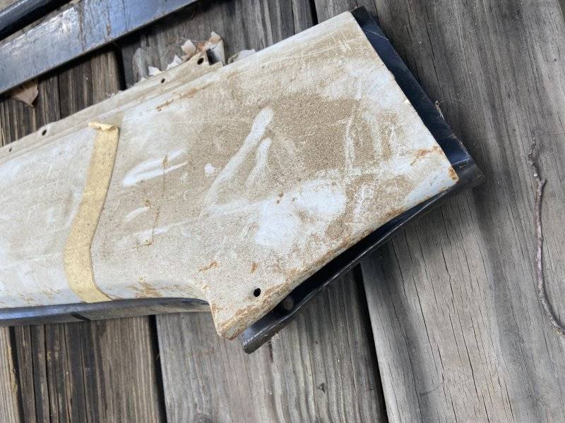

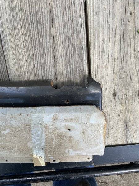

So I’m trying to find the correct upper interior rear quarter panels. I have found several but not sure what the correct part numbers are for my hardtop. I can see the difference for the post vs hardtop type panels. Really don’t want to buy the wrong panels and be stuck with them.
Can someone give any advise on what to look for? I attached a set I was looking for on eBay. Maybe these are correct for hardtop?

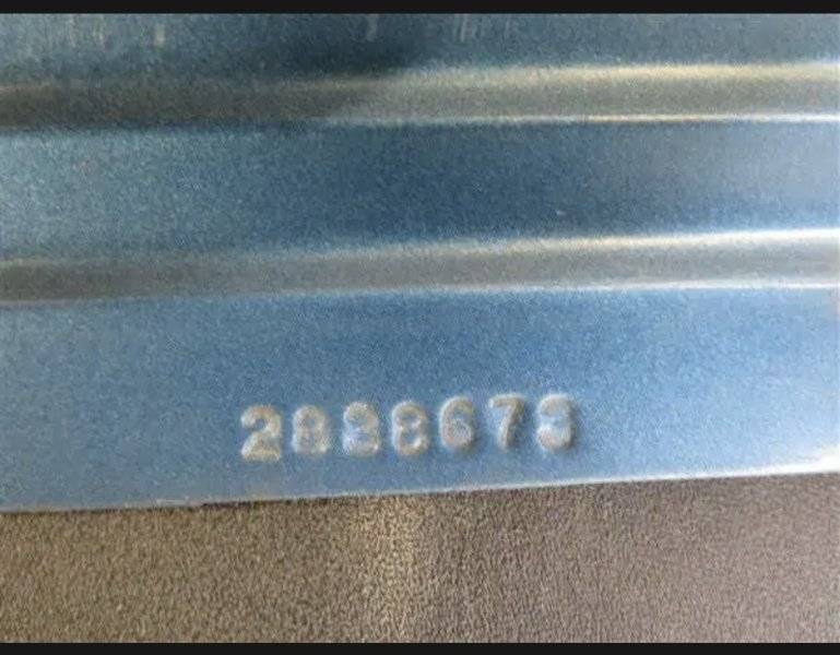

I'll admit that I didn't know that there was a difference in parts for post vs. hardtop panels. However, those stamped numbers are the same as the ones on my hardtop pieces so they should be what you need.

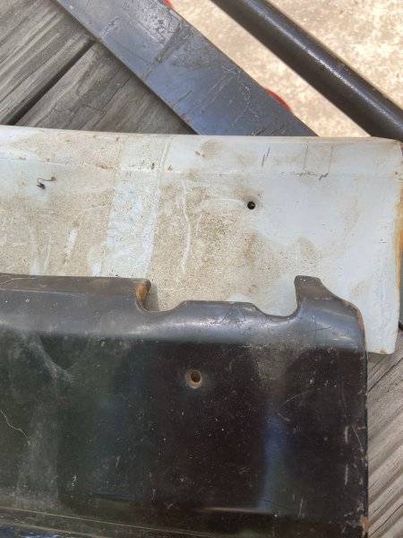

I would say they’re correct, the one’s for the post cars have a contour at the end to go around the post. I own both hard top and post if you need photos of both to see the difference.
There is also a difference in the length from Dodge and Plymouth. The photos you are showing us are for a Plymouth hard top.

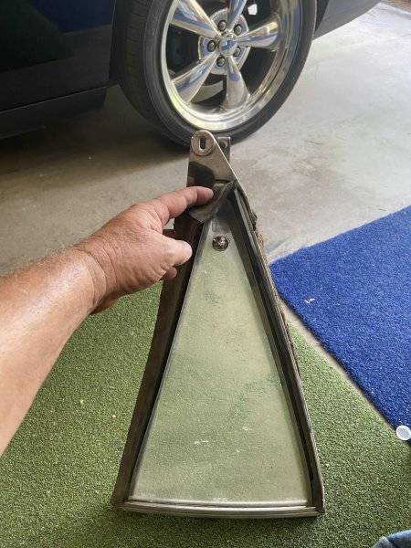

I knew about the window frames but not the interior pieces as well

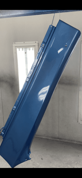

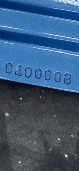

Top photo is Plymouth and the bottom is Dodge. They are different, the bottom one is post top one hard top. Hope this helps.
