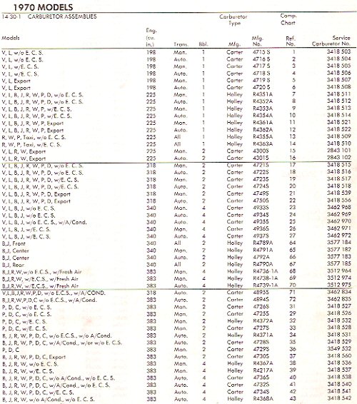

What carb came stock on a 383?
Carter AVS #4732,4734,4736...depends on options.
The RR has a Holley on it. Was hoping it was a Carter. But We will have to work with what's on it...being OEM
OK, then it should be either #4367 (manl),4368(auto),4369(auto w/H51).
Lots of variables for 70. Does it have ECS? A/C? Fresh air hood? Tranny? Here are some from the parts book. The rest are on the back page if you's is not on here.
ECS...???? What is this?, A/C - NO, Fresh AIr Hood - No, Tranny - 727.
AM radio... ;o) Just kiddin
Looking like a R4368A
