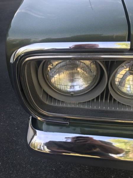

Well, I unfortunately didn’t find what I needed on R/T specialties. I am sure that they have the screws I need there and sell them singularly. I just don’t know which ones I need. I need the ones for the outer trim for the Road Runner. I don’t need anything for the grill as it is mounted and I know why I will have to remove it to insert the screws for the trim. Attached is a picture of the front right C trim that needs screws, I have it just sitting in place. I also need screws for the trim that carries underneath the grill and additionally the trim that mounts to the hood. If anybody has a project in work and could send me the dimensions that would be awesome. Thanks, Ernie

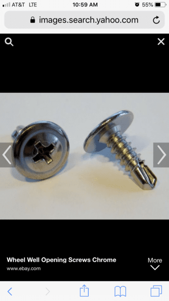

They're something like a #8 screw 1/2" long, phillips head that sort of looks like a non-spinning washer (head of screw maybe 1/4" across). Look carefully at your "c" trim pieces since some of those "screw slots" can widen out requiring a washer or something.
View attachment 819294 Thanks, are like the ones in the photo or a normal non self tapping screw?
The screws in the pic are self-drilling screws, not just self tapping. When I put the C molding on my 70 Satty, the holes in the molding were wider than original and the holes the screws went into were larger that the stock screw too. I had to improvise. They're not that visible so I was just concerned with securing the C trim in place ( it's a hard piece to find and not cheap, especially the repop ones).

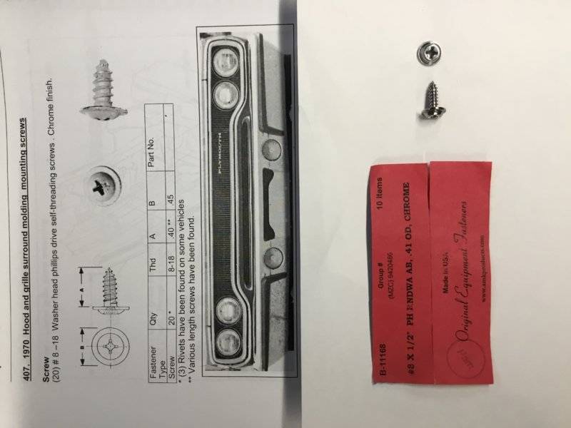

The text information is from the restoration manual and the screw pictured is from amkproducts.

All 4 of my 70 RR/Sats had screws iirc.
I am going to say they were messed with and not original. I have seen too many with Rivets...
Awesome, this helps a bunch, I found a place that claims they have the trim “screws” I will see when they get here (Alaska) in a couple of weeks
