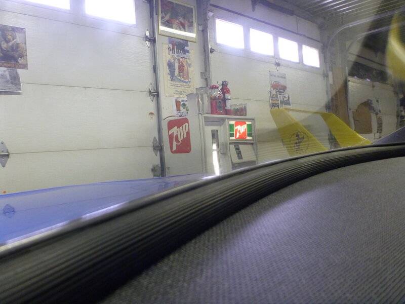

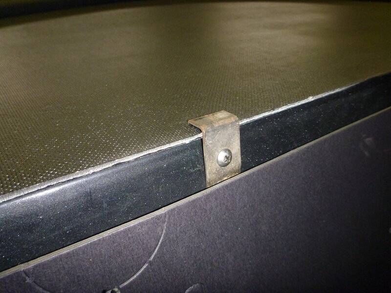

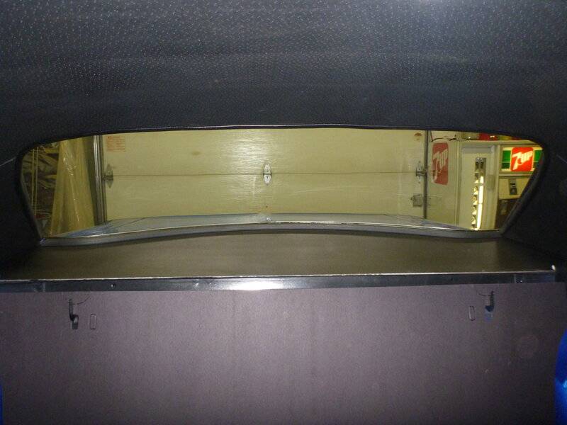

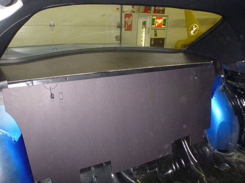

How does this trim get installed? Looks like there is a grove on one side that slips on the end of the package tray then pressed against the frame??

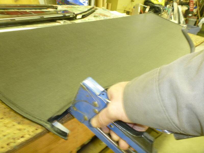

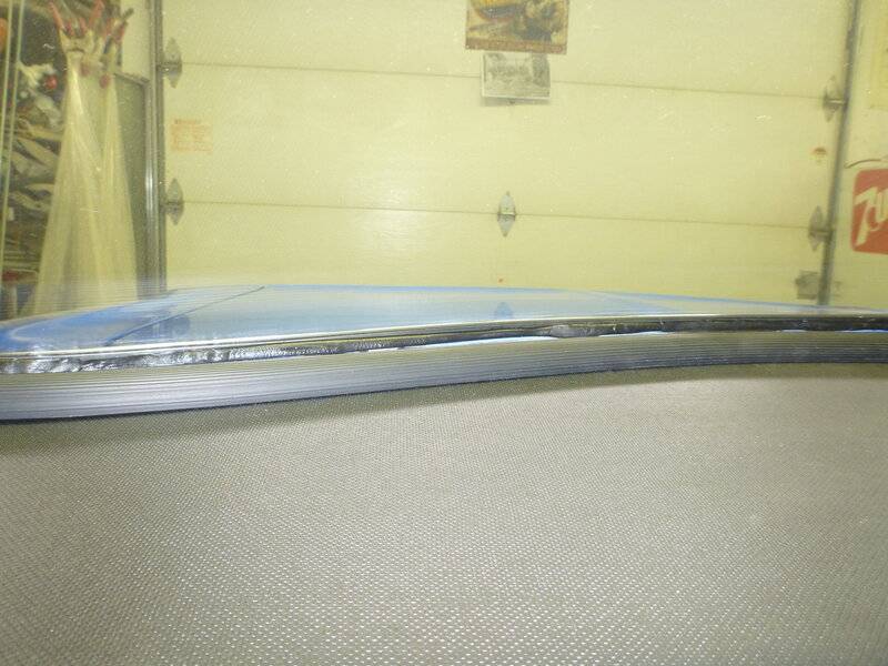

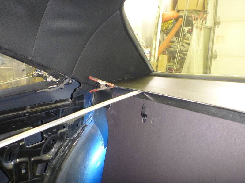

Yes the tray edge goes into the trim groove, then staple it to the tray, slide a yard stick under the assembly and place it so the trim sits on top of the butyl. All covered in my Bee restoration thread.
