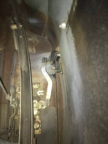

It appears that there maybe be a rod from the door lock cylinder to the assembly that is missing. Anyone have a good website on a replacement with the clips? When I lock the door with it open, I close it and it unlocks.

I’ve tried the key but it won’t lock. If you look at the picture I posted, the door lock cylinder has nothing it’s connected too. I believe it should connect to the lock assembly.

Post a message saying you WTB these rods. See what happens.
FYI - if you get into a pinch, you can make one of those rods out of a coat hanger or a similar rod from another car by bending it. I ran mine like that for years on one door....but the factory rod is MUCH easier
Thank you! I found the rods but don’t know what the clips look like. Classic industries didn’t know. Does anyone know? I just need a picture. Been researching this for days.
I think they're designed like that - so you can't (easily) lock your keys in the car. Push the lock-knob down, hold the door-handle-button "IN" while you close the door - I believe it should stay locked, then. So you have to make a conscious effort......
