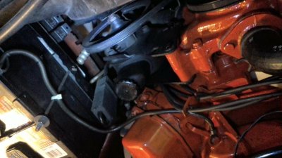

Which steering box and pump would be in a 70 440-6 b-body? Anyone know the best places tou source rebuilt parts, I have plenty of cores...
This is what's in my 70 v code GTX, hope it helps.
Don't know why it's upsidedown
thanks 440+6, I have one like that with a smaller pulley with no holes in it? But I didn't think that was the one, now I am really confused, lol...
They used 2 different ones on 1970's. The one that 440+6 showed is the same as 69's and the most common I have seen on 1970s. The one on mine is more squared on top than oval. My steering is sloppy and I have another steering box and an "oval" style pump I will be sending to Steer and Gear and switch over too. Even though my pump is different it still has the same pulley, with the 3 spokes.

Gentlemen,
The oval filler neck designates a GM built Saginaw pump. The cylindrical neck pump is usually a Federal built pump. The oil cooler on the side of the pump was furnished when the axle ratio was 3.54:1 (Dana 60) or 3.55:1 (Mopar 8 3/4") due to higher engine and pump RPMs. My RS23V0A***** car is a A34 super track pack car with 4.10:1 Dana 60 rear end and has the GM Saginaw pump with the "open" drive sheave (AKA pulley).
Cheers,
RJ Renton
