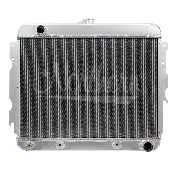

I plan on running a mildly stroked out 340 in my roadrunner (450-500 hp) when I start putting things back together and I currently have the 22'' radiator in my car. Do they make bigger radiators for small blocks that look close to the original style or should I just re core the one I have. I am not opposed to going after market as long as I do not have to drill holes for it but my goal is to make it look as original as possible. Is a 22'' radiator sufficient for my needs? If so, I am happy to go back with one. I just know my brother always said she liked to run hot and I want to avoid that on cruises but I guess that describes most all of us.
Northern radiator makes a darned good product IMO. They make alumninum ones that bolt right into the factory position. http://www.northernfactory.com/AUTOMOTIVE_-_LIGHT_TRUCK/PLYMOUTH/ROAD_RUNNER/1972/205192
