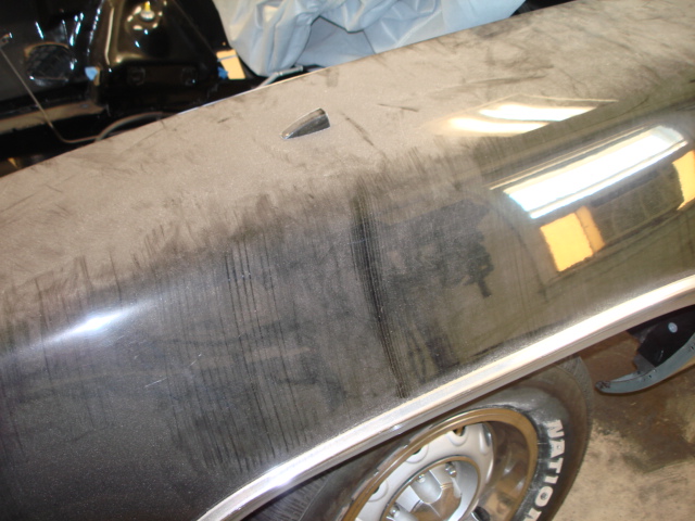

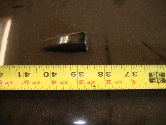

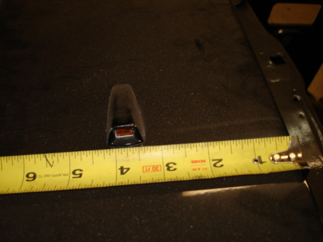

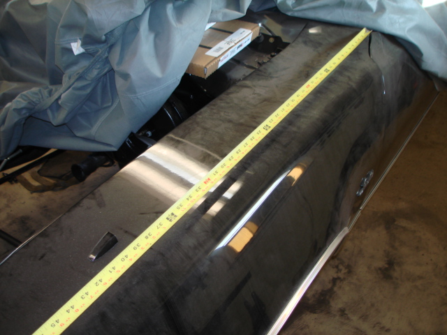

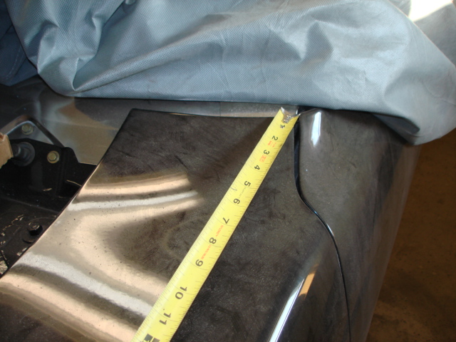

I've searched, but I can't seem to find the mounting location for my 71 Satellite Sebring. Someone welded some holes closed and I think it was for them. I thought it would be neat to put them back on after I buy them. Any help, measurements and pics, would be greatly appreciated.
Pictures show the location for my 72 SSP. I'm not totally sure if the 71 is the same.

You da man! Thank you very much. Now it's time to drill the welds out.
